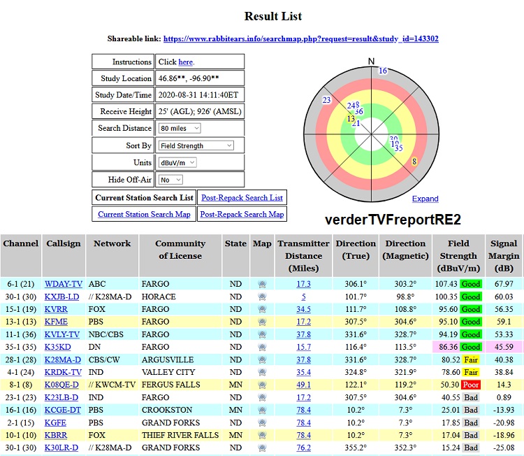

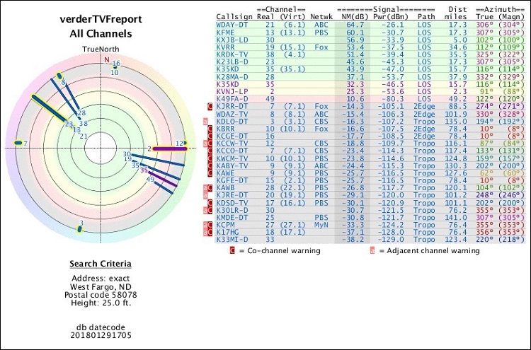

Here is a signal report for your location:
https://www.rabbitears.info/searchma...tudy_id=143302
For comparison, a TVFool signal report for your location would look like this:
http://www.tvfool.com/?option=com_wr...9038e93d573093
I don't think verder can see attachments yet. There are regular attachment to this post, and the images in the post are from my image host imgur.

I used the TVFool Interactive Browser:
https://www.tvfool.com/?option=com_wrapper&Itemid=90
The green signal lines are based on old channel data, but it gives the general idea.

Channels checked:
4-1 (KRDK) COZI, Real channel 24, 324.8 deg True, Signal Margin 39 dB
6-1 (WDAY) ABC, Real channel 21, 306.1 deg True, Signal Margin 68 dB
11-1 (KVLY) NBC/CBS, Real channel 36, 331.6 deg True, Signal Margin 53 dB
13-1 (KFME) PBS, Real channel 13, 307.5 deg True, Signal Margin 59 dB
15-1 (KVRR) Fox, Real channel 19, 111.7 deg True, Signal Margin 56 dB
28-1 (K28MA) CBS/CW, Real channel 28, 331.6 deg True, Signal Margin 40 dB
30-1 (KXJB) CBS/CW, Real channel 30, 101.7 deg True, Signal Margin 60 dB

Thank you for the UHF scan; nicely done.
KVRR virtual 15-1 RF 19 shows a little more than the minimum SNR for reception, but could be a problem at times
WDAY virtual 6-1 RF 21 is your strongest channel; shouldn't be a problem
KRDK virtual 4-1 RF 24 is a little stronger than KVRR; could be a problem at times
K28MA virtual 28-1 RF 28 is very weak; doesn't look strong enough for tuner lock in this scan
KXJB virtual 30-1 RF 30 is fairly strong but shows possible multipath problem. It is listed as second in strength after WDAY, but is a low power station
https://www.rabbitears.info/tvq.php?...s&facid=185885
KVLY virtual 11-1 RF 36 shows just barely enough SNR for a tuner lock and would be expected to have problems
