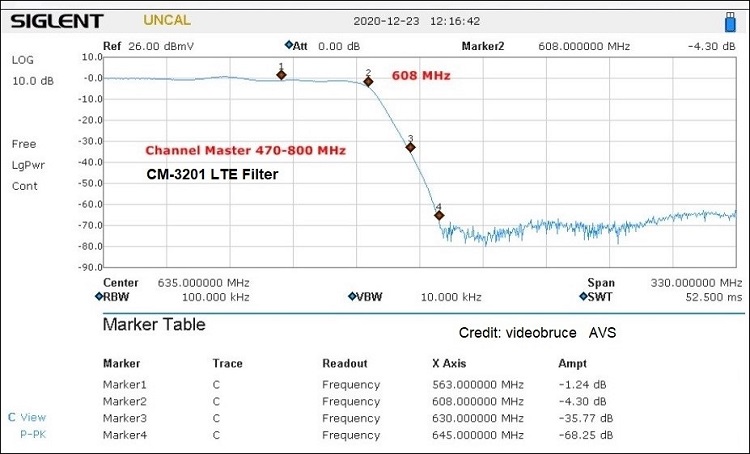

CM-3201 LTE Filter (New) Attenuation
Code:
Attenuation of Channel Master NEW CM-3201
LTE Filter for the 14-36 UHF TV Band
Channel  Input   Output  Attenuation
  RF*     dBmV    dBmV      dB
   14     12.1    11.5      0.6
   25     10.5    10.3      0.2
   34     10.3     8.2      2.1
   35     10.1     8.0      2.1
   36     10.2     6.9      3.3
   37     10.2     3.5      6.7
   38      9.8    -6.0     15.8
   39      9.2   -18.3     27.5
   40      8.5   -31.5     40.0
Input level to filter increased 20 dB
because of increased filter attenuation
   50     29.3   -42.3     71.6
   55     27.1   -46.0     73.1
* Frequency of measurement for each channel
was video frequency if it had been an NTSC
channel; i.e. 1.25 MHz above low end of channel
Equipment used:
CM-3201 LTE Filter
F-81 Adapter
Blonder Tongue HAVM UHF NTSC Agile Modulator
Sadelco DisplayMax 800 Signal Level Meter
For comparison, a measurement of the filter by videobruce:
