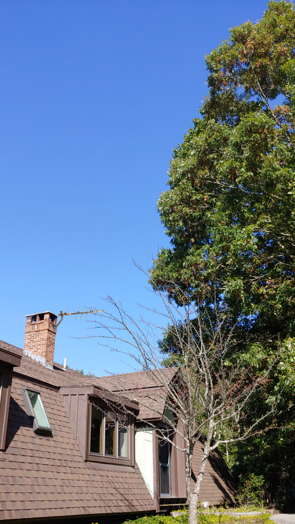

I did a quick photoshop to see what the 751 would look like mounted at the highest point (chimney) either with the supplied mast or with a taller mast. No mast will be tall enough to get above the tree line.
Do have a spot anywhere on your house where the antenna can get a clear shot without looking directly into the trees? Trees with leaves, especially wet leaves, are really troublesome for UHF.

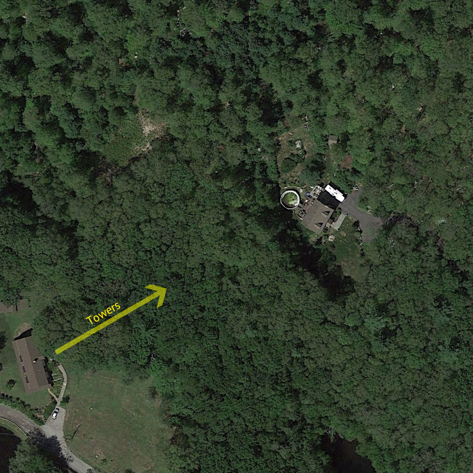

Unfortunately not. I could put the antenna at the very southern end of the roofline, which would help a bit. I could cut down a couple of trees closer to the house, but there are thousands more right behind them.

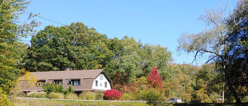

Here's a photo pointing roughly in the direction of the transmission towers. As you can see, it is almost impossible to get above the tree line. Let me know if that changes your recommendation.

It looks like the southern end of the house has the best shot of seeing the RI towers. If the 751 doesn't work, a Winegard 7694 has a little more horsepower that might pull them in. There is also the 7698, which has even more gain), and possibly the Denny HD-Stacker (made by Winegard), which has similar performance to the 7698 but in a shorter overall length, due to the stacking.
Also, don't underestimate the effect of height. A couple feet up (usually) or down (occasionally) can make a big difference.
I recommend using temporary setups to try 751 at the chimney first. If that doesn't work, then try it at the south end. Then move on to rigs with more gain. Choose suppliers with liberal return policies. Be sure to use good quality RG-6 (preferably less than 50-feet) going directly to only one TV to start. You don't want to muddy the waters of your reception problem with distribution gremlins.
