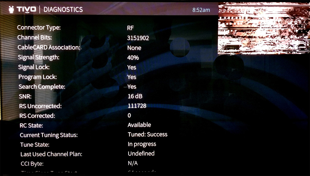

The attached screenshot is from the best screen I ever owned, a 60" plasma by Panasonic. (it's gorgeous) The feed comes from a TiVo Roamio OTA Series 5. (Perhaps later we can discuss their use of % as a unit of measure.)
I'm located in Rockport, Maine, 40+ miles from RF Channels 2, 7, 9, & 13 in Bangor. The antenna is the VHF section, only, of a ChannelMaster 3020 with their new version 3 of the CM7777 preamp. I'd like to add something like the variable gain SKY38323 distribution amp ahead of the TiVo. Specs say it can add 25dB to VHF signals.
Signal levels, expressed as a %, vary from day-to-day, hour-to-hour, from a low of 37% to a high of 60% and better. Of course, SNR tracks that, predictably. Most days, most channels are virtually free of dropouts. There are 4 ATSC tuners in the TiVo. Even for quite low signals, the TiVo reports Signal Lock, Program Lock, and Search Complete to be "Yes."

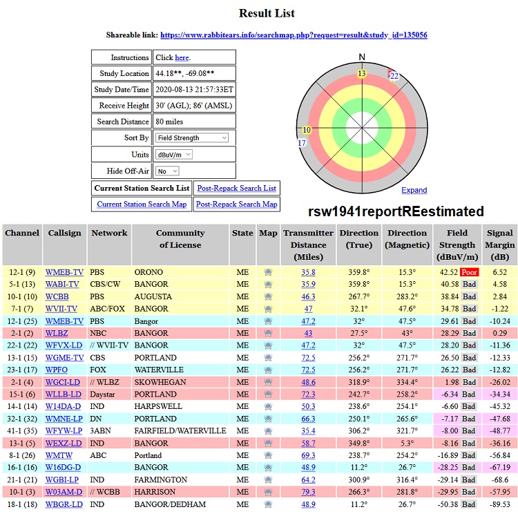

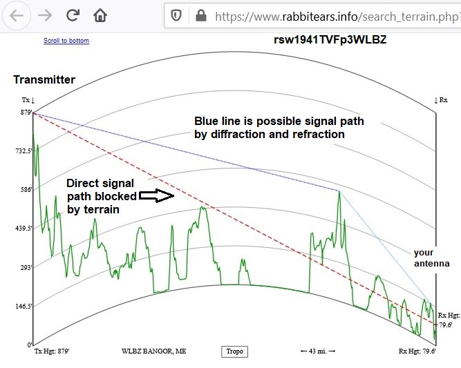

Here is a sample signal report from rabbitears.info showing very poor signals at the intersection of Ship St and Pascal Ave in Rockport:
https://www.rabbitears.info/searchma...tudy_id=135056
You can do your own report for your location here:

The TiVo signal strength is just a relative scale; 40% is very low. An SNR of 16 dB is just barely enough. Uncorrected errors should be zero; 111728 is way too many. Corrected errors are never shown, for some unknown reason.

The WLBZ terrain profile from the sample report shows a very difficult signal path with your location behind a hill:

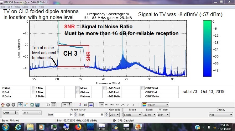

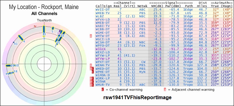

When you say, "The SNR is measured from the noise level to the top of the signal." do you mean from 0, or from the top of the noise level?
I'd hate to replace the antenna, but would consider doing so if there were one with a better VHF section. Can you suggest one? Keep in mind that I removed the UHF section and attached the balun directly to the end of the connectors that reached from the VHF section thru the UHF section. Might a gain of even 2 or 3dB on Channel 2 be significant? SNR of 17dB and better generally delivers a rock solid signal.
Because I was having issues with an earlier preamp and thought I might replace it, I located the connection at the bottom of the 10-foot mast, not up directly under the antenna. This added at least 10 feet to the cable from the balun to the preamp. BAD idea?
I should have posted a version of the map and table of data from TV Fool. The file is attached.
Thanks,
Steve
From the top of the adjacent noise level. This scan was made with an RST-SDR.COM V3 dongle and free open-source spectrum analyzer software from GitHub. The software is not available ready-to-use. It is necessary to assemble it in a folder. I found that difficult to do, but finally got it to work. The dB scale numbers are only relative, not absolute.
This is the screen shot that goes with that test. The SNR given by the tuner is actually MER based on the constellation diagram. It would be difficult to measure the noise level in a channel that's in use:

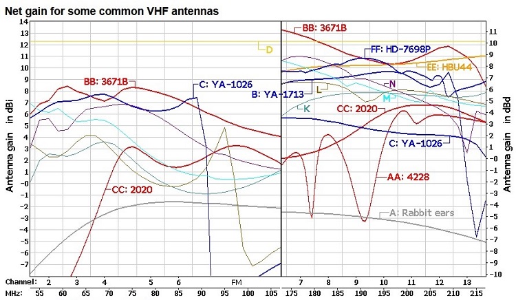

I found the net gain for the 2020; the channel 2 gain is poor. Since the 3020 has more elements in it's LPDA VHF section, I assume that it would do better on channel 2.
http://www.hdtvprimer.com/ANTENNAS/comparing.html
I see that CM has brought back the 3671 (Ultra-Hi Crossfire 100):
https://www.channelmaster.com/Digita..._p/cm-3671.htm
This is a gain chart for the Winegard HD8200U, note gain is in dBd, not dBi
It's difficult to predict how much that mod might have changed the VHF gain. In the review of the 3020 by Tyler that I linked above, he said (at 1:03) that the location of the balun affected the performance of the antenna.
Thank you for the image of your report. My guess was pretty close. I prefer a link to the report, so that I can click on the callsign to see the terrain profile. I had hoped that you would have done a rabbitears.info report, which would have been more accurate because the reports generated by TVFool use an outdated database.
Sometimes I ask a poster for his address and antenna coordinates in a PM for privacy. That allows me to look at the sat view of the location to see if there are any objects in the signal path like trees.

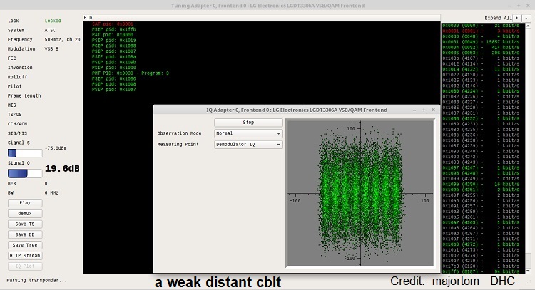

For digital television I wish I could find a low cost tool that would display the constellation plot of the signal. This can give good clues as to why you are having trouble with a signal. The closest I have seen is the HDHomeRun Tech, but that is not a full constellation plot it is a histogram of the I signal rather than a plot of I vs Q.

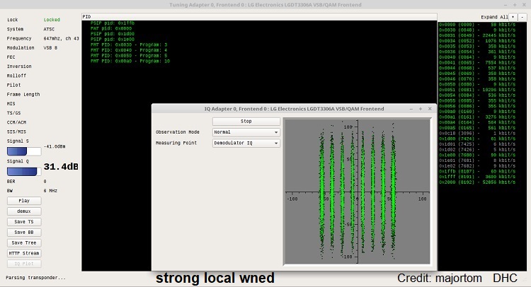

Majortom on the Canadian forum has worked out a low-cost method. It requires Linux software manipulation which is a little beyond my ability. I'm happy with just signal strength, SNR and errors. The shape of the signal when finding the best location for an antenna is also useful. Fewer notches seems to be better.
https://www.digitalhome.ca/threads/o...5/post-2919953
I modified the linux driver for this usb atsc tuner to allow plotting the received constellation, using updateDVB.
Working pretty good here...
a weak distant cblt
https://www.dropbox.com/s/p59zq8f1dh...qplot-cblt.png
strong local wned
https://www.dropbox.com/s/w9ue0jg7fg...qplot-wned.png

Old 30-Aug-2020, 8:07 PM   #16
Originally Posted by rsw1941 View Post
Is there ANY chance analog modulation of RF channels back in the late 60s behaved any differently, with regard to ambient noise?
Hello, again rsw1941.
Since I don't know your specific concern about ambient noise, I will have to give a general answer.
The ambient noise at any location will reduce the SNR of both analog and digital TV signals.
With analog signals, as the noise level increases, you will see more and more white specks in the picture of VHF signals. As the noise level increases even more, there will be even more white specks until you reach the point where the picture is nothing but snow. The picture never drops out like it does with a digital TV signal.
With a digital TV signal, as the noise increases more errors are created, but the picture quality doesn't change until you reach the "Digital Cliff."
The FEC (Forward Error Correction) corrects the errors, but it has a limited ability. Once that limit is exceeded, the errors increase and you have pixelation, picture freeze, and finally dropout. If there were no FEC, the picture quality would gradually deteriorate, which would be even more annoying than the sudden loss at the cliff.
I have been helping a poster in NJ with low VHF on the satelliteguys forum. I taught him how to use a $25 RTL-SDR.com dongle and SDR# (SDRsharp) software to check the SNR of his signals. I suggest you take a look at that thread:
Low VHF interference
https://www.satelliteguys.us/xen/thr...erence.367781/
The 2020 posts start at post #51
Newer version of software. The display doesn't have to be dark, you can set it to a lighter theme, which I actually prefer. I set it dark to match the scans done by freeisforme on the satelliteguys forum:
One of these videos should work:
https://www.dropbox.com/s/w62g62arag...02-32.mp4?dl=0
https://www.dropbox.com/s/w62g62arag...02-32.mp4?dl=1
One nice advantage of having an inexpensive spectrum analyzer is when you are doing a channel scan. If a channel doesn't show up, you don't know if it isn't there or just too weak. The spectrum analyzer will give you the answer.
When installing a mini-CATV system on a 10-acre school campus way back, I vaguely recall using a distribution amp at each building.
That is the correct procedure. You want to make the signals stronger before they are split. If you don't, the SNR will be reduced as the signals get weaker. Once the SNR is reduced, you can't get it back.
