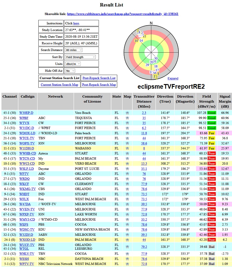

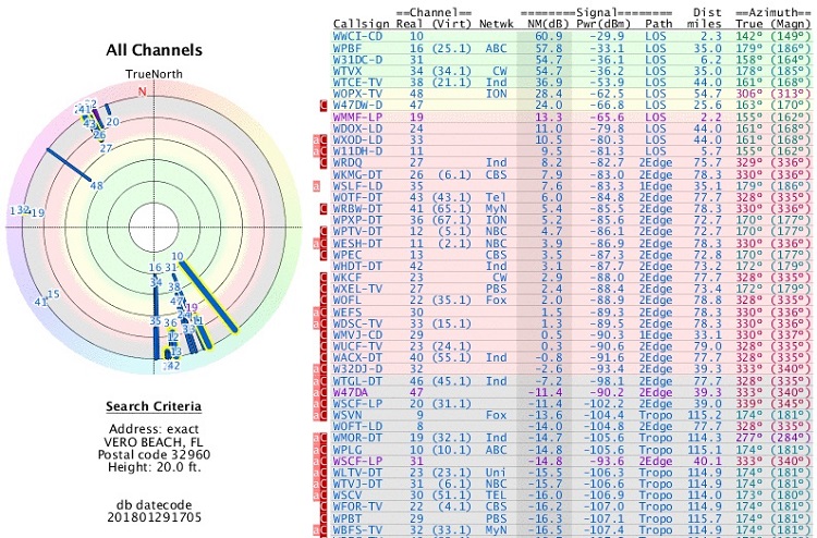

Here is a report from rabbitears.info, based on my estimate of your location, which should have a more accurate list of channels because TVFool is using a database with errors:
https://www.rabbitears.info/searchma...tudy_id=138161
The Signal Margin is similar to Noise Margin.
The Winegard HD7698P combo antenna would give you a good chance with those weak signals. The new instructions for the antenna are very confusing. It is important to open the VHF elements in the correct order so that they alternate.
I suggest WKMG for CBS and WESH for NBC; ABC should be strong enough to come in from the rear. NBC will be the most difficult.

Thanks, Rabbit!
So with this list, how far down would you figure I might be able to get?
Both WPEC (CBS) and WPTV (NBC) from West Palm Beach are listed as bad on this report, so I am guessing they will be no goes?
Maybe WKMG (CBS Orlando)? But this would, I assume, require a 2nd antenna to point in that direction.
Suggestions? Thanks!

I redid the report image to include WPEC CBS at the bottom. It's even weaker than WESH and WPTV for NBC.
If a channel is listed as Bad on the rabbitears report, it doesn't mean impossible, it just means difficult.
In theory, it is possible to receive a signal as weak as -15 dB NM on a TVFool report if you have an antenna with a gain of 18 dB:
The signal reports are just computer simulations, known to be less accurate for weak signals.
Why don't you try both directions when you put the antenna up. I favored aiming the antenna north so that the strong WPBF coming from the south would be at the rear. If you aim south, WPBF would overload the preamp and tuner.
There are many solutions, that is just one possible solution.

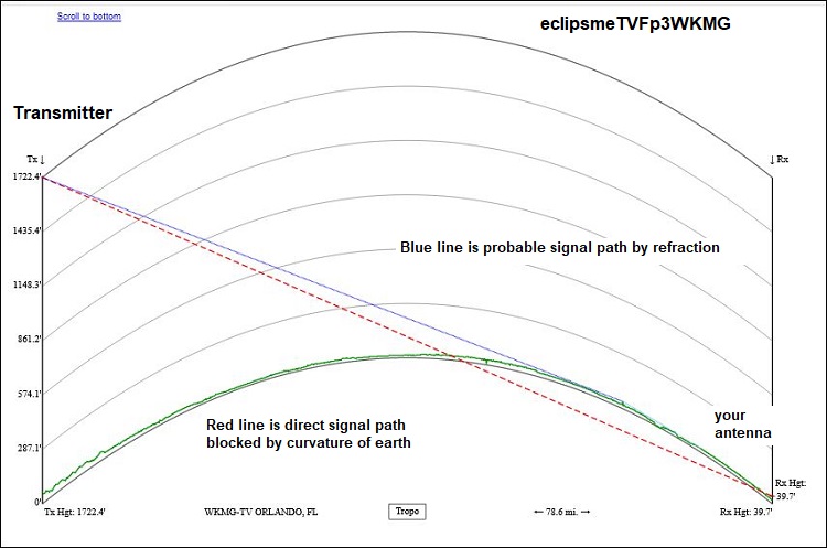

You are on the fringe of coverage for WKMG:
http://forum.tvfool.com/attachment.p...1&d=1597889062
The curvature of the earth blocks the direct signal. The signal is rated Tropo which means reception is affected by atmospheric changes.
You can see similar images for your other channels by clicking on the map icon for coverage and clicking on Transmitter Distance in your rabbitears report.
