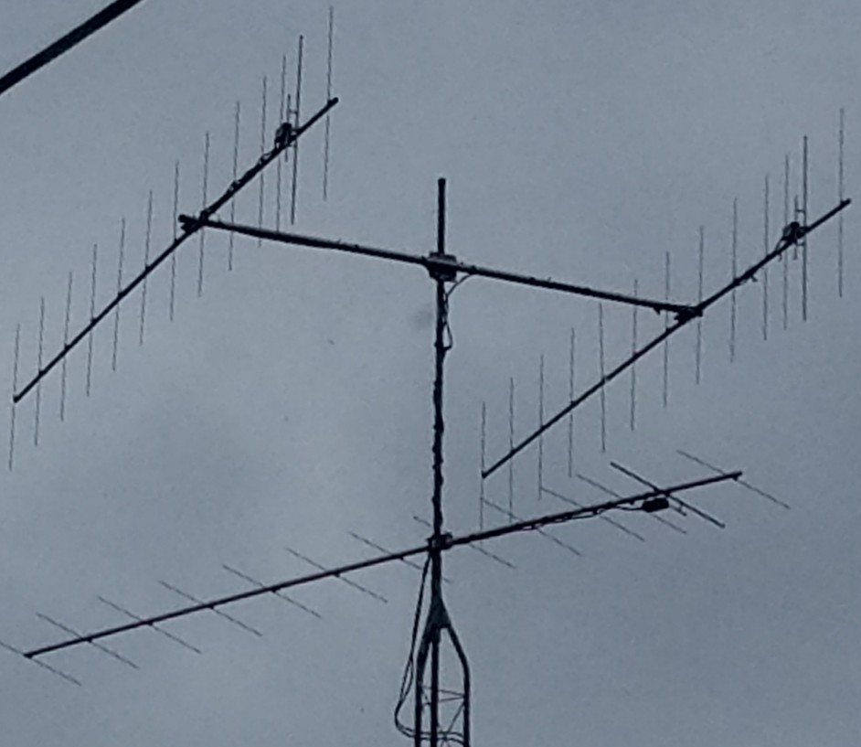

Antenna Spotting in Kenosha #6
This one's really easy to see on 22nd Avenue on the corner of 76th Street I think.
Is it a TV antenna?

My guess would be "probably not" but without proper scale and perspective, it's not possible to accurately identify their purpose.
Observations:
1. All three antennas appear to be identical Yagis cut to the same <unknown> frequency.
2. The two upper antennas are ganged to focus on one azimuth and are mounted for vertically polarized operation.
3. The lower antenna is horizontally polarized and aimed in a direction that appears to be about 30 degrees to the left of the upper pair.
Interesting....

Best guess... Ham band, but as ADTech said, with no scale reference we can't make any firm conclusions.

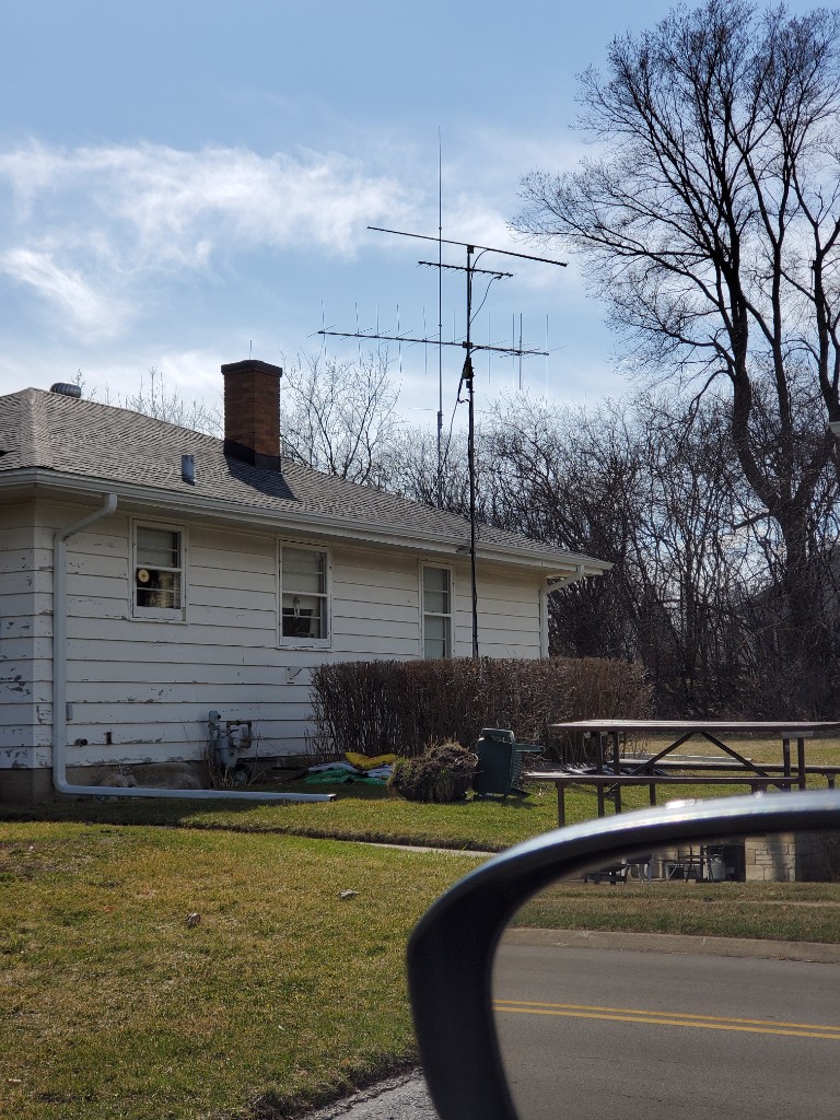

Antenna Spotting in Kenosha #6 zoomed out
Sorry I originally cropped it to get the size down I found this handy-dandy photo resizer for my Samsung phone.

Well, the lowest one is a TV antenna. Looks like an old radio Shack U-75 or U-90.
Unfortunately, with the upper antennas viewed against the sky, there's no reference scale so as to estimate the length of the elements or the boom.
Yeah, I'd also suspect amateur radio for those upper antennas. Maybe if an old-time amateur operator drops in, they might be able to comment.

The top set of beams looks to be a Cushcraft A26B2 beam installed with vertical polarization for the 144 to 148 MHz ham band. (It is essentially two of the Cushcraft A13B2 beams installed on a stacking boom and connected with a phasing harness.) Vertical antennas on this band are usually used for FM voice operation with handheld, mobile and base units. With this much gain they are most likely operating on simplex channels.
The beam just below it is a Cushcraft A13B2 beam installed with horizontal polarization, also for the 144-148 MHz ham band. Horizontal antennas are usually used for SSB (single sideband voice) and CW (Morse code).
Just for a reference, the booms on these antennas are 15 ft long and the elements are about 40 in long. It does look like one of the beams has slipped a bit on the mast and is pointing a little bit off.

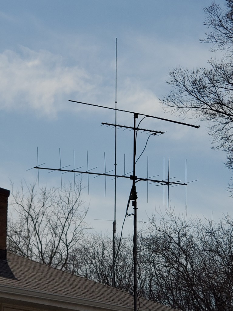

Antenna Spotting in Gurnee..
I saw similar antenna at a residence although it looks a bit different:

Just above the rotator looks like a 10 element crossed yagi beam for the ham 2 meter band (144 to 148 MHz)...it is both horizontally and vertically polarized...probably about an 11 ft boom. Possibly a Cushcraft A148-20T or comparable.
In the middle appears to be an 11 element yagi beam for the ham radio 70 cm band (420 to 450 MHz)...about a 4-1/2 ft boom. Maybe a Cushcraft A430-11S or A449-11S or something similar. Mostly used for SSB (single sideband) voice or CW (Morse code).
The top most antenna is probably for the 23 cm ham band (1240-1300 MHz). Difficult to see the detail, but probably a 35 element yagi beam on about a 10 ft boom. Similar to the M2 Antenna Systems 23CM35. Mostly used for SSB (single sideband) voice or CW (Morse code).
Not sure about the vertical antenna in the background, not enough detail in the photo. Looks similar to a 2 meter ham band (144 to 148 MHz) vertical base station antenna with three 5/8 sections in phase. Would be about 15 ft tall and typically used to work FM voice stations either simplex or through repeaters.
