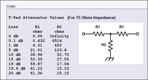

T-Pad Attenuator
Code:
T-Pad Attenuator Values
Loss       R1       R2
          ohms     ohms
0 dB      0.00   Infinity
0.1 dB    0.432   6514
1 dB      4.31     650
5 dB     21.01     123.4
10 dB    38.96      52.70
15 dB    52.35      27.55
19 dB    59.87      17.04
19.9 dB  61.22      15.33
20 dB    61.36      15.15
