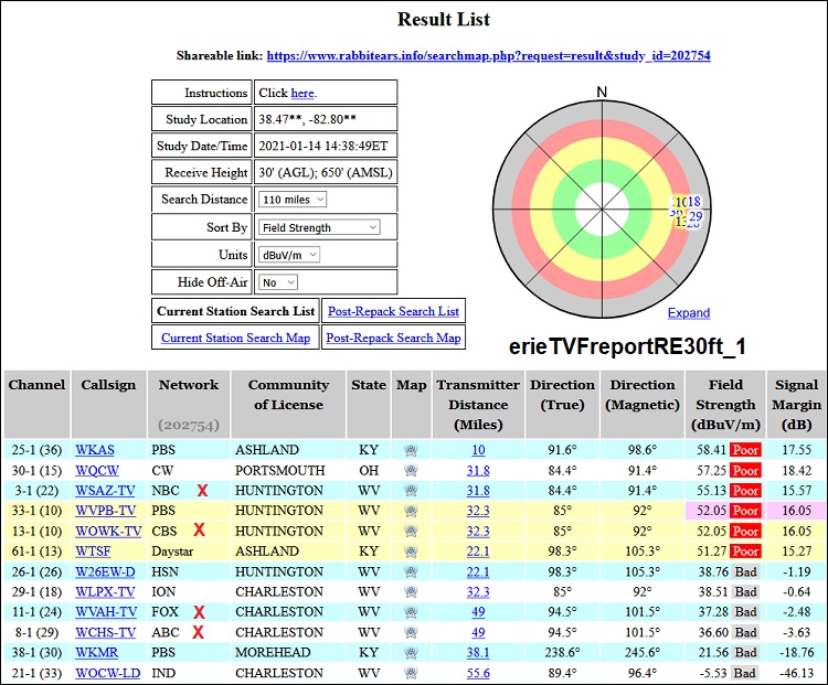

Thank you for the reports. You live in a poor location for OTA reception. Reception is not impossible, but it will be difficult.
The TVFool reports are no longer accurate because the database for generating reports is out of date. We are now using reports from rabbitears.info. You can do one here:
I did two reports based on my estimate of your location (I use coordinates from Google maps):
30 ft
https://www.rabbitears.info/searchma...tudy_id=202754
100 ft
https://www.rabbitears.info/searchma...tudy_id=202758
The Signal Margin on a rabbitears.info report is similar to the Noise Margin on a TVFool report.

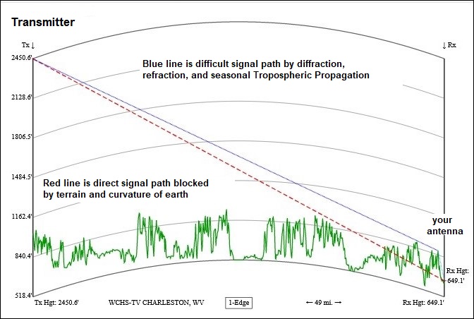

You will need a UHF/VHF combo antenna like the Winegard HD7698P and a preamp or separate UHF and VHF antennas. NBC and CBS should be fairly easy but Fox and ABC are in a different direction and much weaker.
Also, you are behind a hill for all your desired channels.
