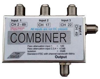

Question #1 is a whole new can of worms. You can try using a splitter in reverse first, but you will likely need two separate downleads and an A/B switch a the TV.
Or a custom combiner designed for the channels at your location. There is a seller on eBay (jan_jenca) who makes and sells them at reasonable prices.
