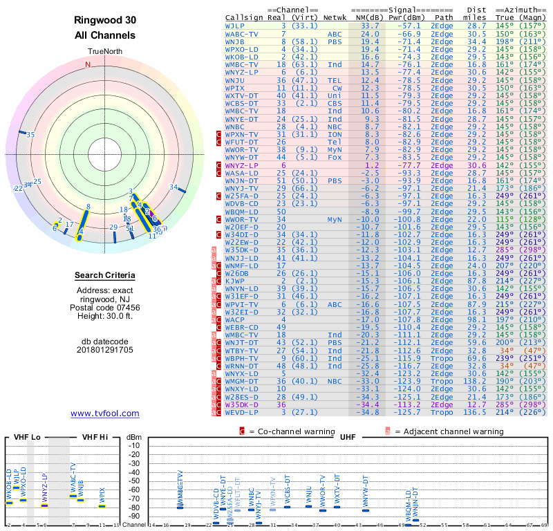

So, real world time. We're in the fringe due to good size hills and lots of trees, even though we are only 26 miles from Central Park in NYC. (We are located in NJ, northwest of the city.) The Radar map (attached, 30 foot antenna ht) has us at 2 Edge reception for all channels, mostly courtesy of a 1000' peak about half a mile from the house. The good news is there is a saddle almost in line with the transmitters, and which is about 100 feet higher than our house.
Virtually everything I want to receive is in the same direction, about 145-160 degrees true. Thus I am looking at some directional antennas. I want VHF Hi and UHF. I am looking to get the major broadcast channels, plus a PBS, ION and MyNine (lowest NM = 7.9 dB with a 30 foot antenna).

Th TVfool database is missing some channels. Also, many channels will be moving on or before August 2, 2019. You will get a PBS when aimed at either Empire State Building or the Freedom Tower. You could consider ignoring WNJU.
If you want real channels 2, 3, and 4; consider the Channelmaster 3018 https://www.channelmaster.com/Digita..._p/cm-3018.htm If you think that the programming on those three channels are not needed, the Winegard HD-7698P would be a good choice.
The LNA 200 preamp that you selected has enough gain to overcome the loss of a three way splitter plus about 100’ of coax, so I wouldn’t buy a distribution amp until I knew I needed one.

I got lucky and finally found detailed information on the CM-5020 antenna. Gains for VHF lo, hi and UHF are 4.5, 10 and 16 dBi (so ~2.4, 7.8 and 13.8 dB respectively). The 15-20 dB most sites were listing is the front to back ratio. At 109 inches long, it should work physically for me.
I am going to give it a try in the attic for grins to see what I can get. Back in the day (2003), we got just one channel with a tv top VHF/UHF antenna (Fox, ch 5), so there is some hope.
