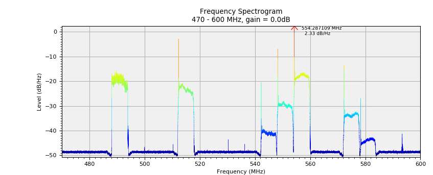

Here's an example of a channel I am not able to pick up (channel 17), despite appearing to have a strong SNR when I did a RTL SDR scan.

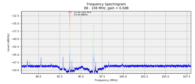

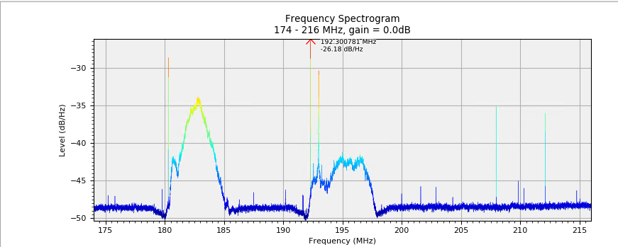

I've attached my RTL-SDR scans. There's nothing notable between 600-800MHz with the LTE filter
