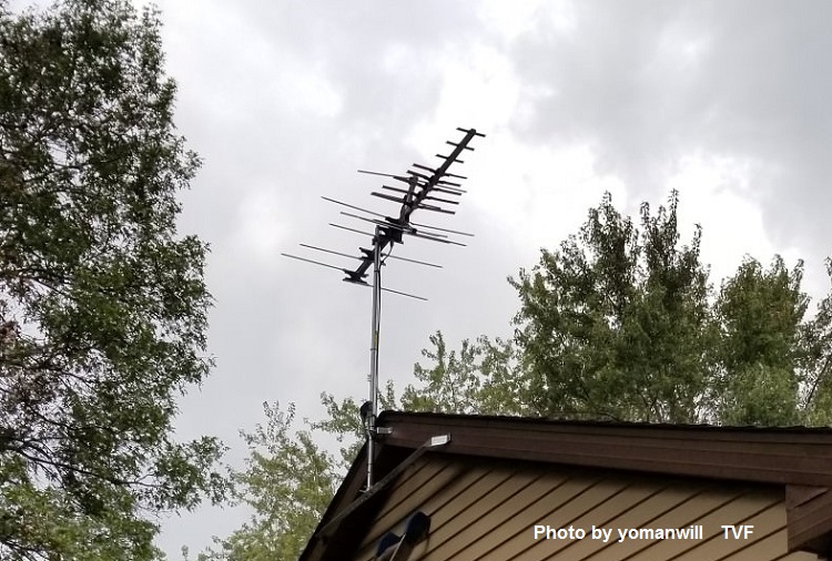

Welp no dice in the attic. Pulled in a number of channels, but between medium to weak. WJBK went out when the wind blew. Going to have to mount outside.

You don't know till you try. We have a have trees surrounding us, most just on the lot lines. The oak wilt hasn't got them yet.
Will moving to a gable mount outside help OR should I do some fine tuning with the setup I have?
Now that the rain/wind has died down the signals are "medium", Samsung TV has a level bar hard to give a exact number.

Massive success. We had a nice bit of rain/wind come though WJBK dropped down 40%. Now that it has passed 100% signal. I'd say moving from the attic to open air easily made a 50% improvement.
https://imgur.com/a/H4umNkQ

Thanks for the report of improved reception and the nice photo.
Good job!
