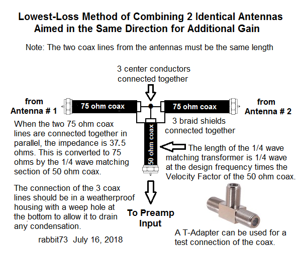

You can combine two IDENTICAL UHF antennas aimed in the SAME direction with a splitter in reverse for more gain; the two coax lines from the antennas to the splitter must be the SAME length.

This is the only way I know how to do it:
The above method uses off-the-shelf parts, but there is also a lowest-loss method for an additional 0.5 dB gain, and it requires special DIY connections.

This is a method of connecting two antennas in parallel for more gain. It gives the most gain for two antennas, but it isn't easy to do.
This method is used by Calaveras of AVS for his two 91XGs.
http://www.aa6g.org/DTV/index.html

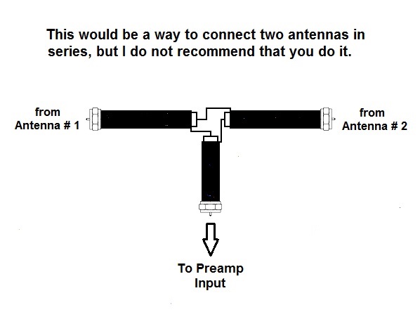

This would be one way to connect two antennas in series, but it is not a good idea.
