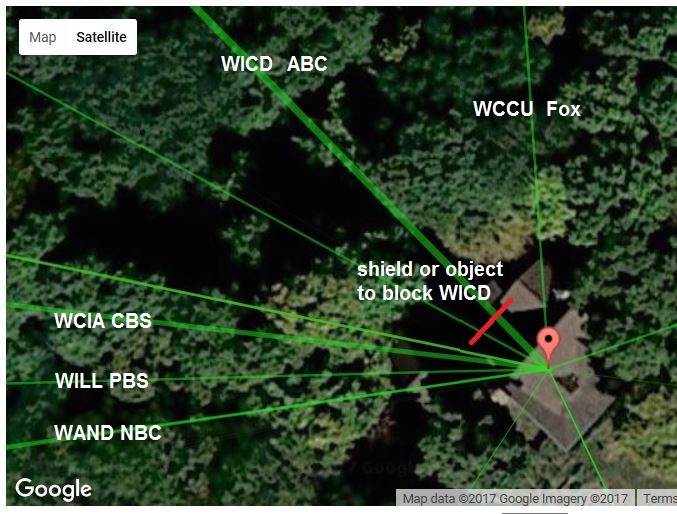

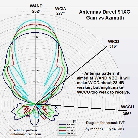

You have a problem location with channels in different directions, trees in the signal paths, and a very strong local signal that is already in the overload category. The ideal solution would require multiple antennas and filters, but a simple solution might work with a little experimentation.
I suggest an Antennas Direct C2V, aimed at about 270 degrees magnetic to favor NBC and CBS. Fox is in a different direction, but it might come in. The VHF dipole for the C2V should be able to pick up PBS.
My biggest concern is with WICD that is so strong it will prevent the reception of the weaker channels, as you have already experienced with your indoor antenna. It is, unfortunately in the same general direction as your other channels, so a directional antenna probably will not help, unless you are willing to experiment further, to place WICD in a null in the antenna pattern to make it weaker.
If you are not willing to do that type of experiment, then you will probably need a custom filter from Tin Lee Electronics to make WICD on real channel 41 weaker. WICD will be moving to channel 32 in a few years, so you would have to order another custom filter.
http://www.rabbitears.info/market.ph...&callsign=wicd
WICD has a Noise Margin of 77.3 dB, even before adding antenna gain.
This might work:
The narrow beamwidth of the 91XG will make WICD a lot weaker, but it has more gain than necessary. Insert an attenuator in the coax of about 10 or 15 dB to keep WICD weak without making NBC too weak.
If you need WILL PBS, add an MCM 30-2475 VHF antenna aimed at 272 degrees magnetic. Combine the two antennas with a UVSJ.

Old 14-Jul-2017, 6:53 PM   #14
It's not an easy prospect but if you can position the
antenna where it cannot be seen line of sight by WICD, you have a
decent chance of success.
That's an interesting idea; it might work. It would be necessary to ground the coax with a grounding block to make WICD weaker.

In this case, you may NOT WANT to mount a roof antenna.
It will be better to use your home as a block to WICD.
A "J" mounted antenna, properly grounded, gives you, by
far, the best chance for success..... You can mount on
the eaves, on the side of your home or even from a ground
mast. Be certain to keep the antenna away from trees so
it has a good view of your weakest signals...

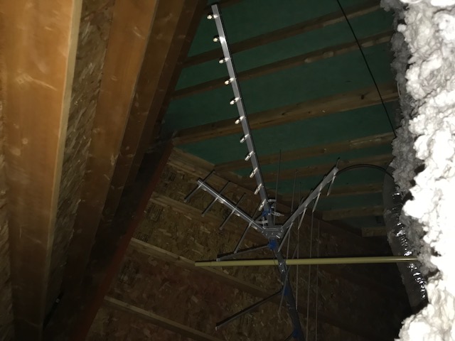

OK many months later we are getting good results with an antenna in the back yard (temp. mounted on a tripod stand) but sometimes having problems pulling in WCCU-DT 27.1 360 north about 17.8 miles away. It's there but video "freezes" intermittently. Some nights it's great, other nights audio comes through but video freezes. Could this be from interference of WICD 41 being so close? or is it another issue? I did discover a antenna in the attic a very long (6 feet?) antenna that works great but still can't reliably pull in WCCU. I aimed it 360 degrees in the attic, but getting the same results and the back yard bay-style antenna. I'm real close to pulling the plug on dish, would be great to get these channels. Thanks in advance!

Thank you for the report and the interesting photo of your attic antenna. I edited the photo to make it easier to see the antenna.
Is the antenna aimed at WCCU?
Yes
Have you tried a shield to block the antenna from receiving the very strong WICD signal, as JoeAZ suggested? Aluminum foil on cardboard might work, since it's in the attic.
What antenna are you using in the back yard?
Is the antenna coax grounded with a grounding block connected to the house electrical system ground? It is not required with an indoor antenna, but it might help to reject interference.

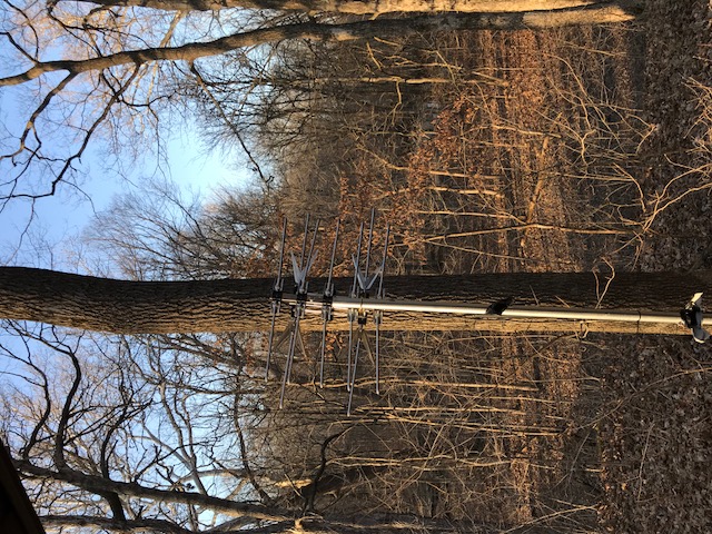

Here is a pic of my outside antenna. The WICD 41 tower is BEHIND the tree. So far it's just been a either/or experiment. I don't really know what kind of antenna that is in the attic (or exactly how to shield it with foil and cardboard from WAND 41) Again I would really like to be able to get WCCU DT 27.1 When the interference happens, I see little color squares popping up over the top of the old B&W re-runs I like, so does this mean WICD 41 is trying to come in over the top of WCCU? Thanks again for all the help!
