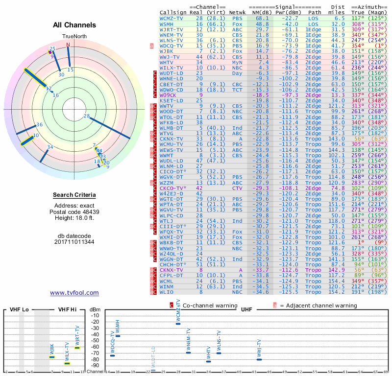

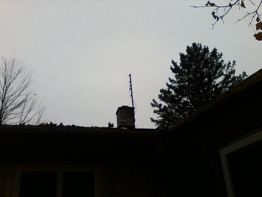

I've had a homemade 4 bay antenna on my roof now for over 2 years now. Everything has been working great until a few months ago when VHF channel 12 stopped being reliable. This antenna works great for UHF but not so hot for VHF. I was wondering if the Clearstream 2MAX would be a better option.

The reason I was asking about the 2MAX is that there is also WJBK on VHF 7 on the opposite side of WJRT 12.
Also for the past 2 days WJRT has been coming in great. Weird.
