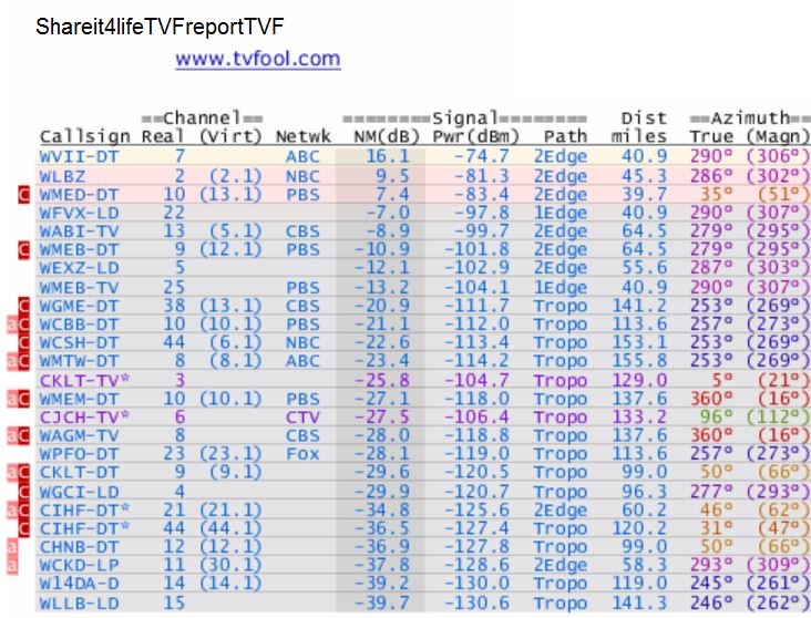

Also here is the TV Fool signal report for reference:
http://www.tvfool.com/?option=com_wr...9038753c7310c5

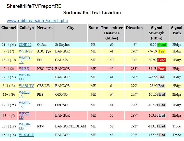

here is the information requested.
http://www.tvfool.com/?option=com_wr...9038466587e4e3
I can return the antenna that i purchased as I only purchased it 5 days ago. Any suggestion on what antenna to replace it with?

Thank you for the more accurate report. To receive WLBZ NBC, you will need a BIG antenna that covers VHF-Low, real channels 2-6. There are four antennas currently available, the Winegard HD8200U, the Solid Signal HD8200XL clone, the Channel Master Advantage 100/CM-3020, and the Channel Master Masterpiece 100/CM-5020.
https://www.solidsignal.com/pview.asp?p=hd8200u
https://www.solidsignal.com/pview.asp?p=hd8200xl
https://www.channelmaster.com/Digita..._p/cm-3020.htm
https://www.channelmaster.com/Master..._p/cm-5020.htm

The picture shows a UHF antenna for real channels 14-51, and an antenna for VHF-High, real channels 7-13. His antennas do not cover VHF-Low, real channels 2-6.
You have WLBZ on real channel 2, so you need an antenna that covers VHF-Low.
UHF, real channels 14-51
The virtual channel number (like 5.1) is a holdover from the analog TV days to maintain the identity of the station, and is what the TV displays.
The photo shows how someone else mounted his antennas in a tree. It doesn't mean that you must do exactly what he did. His channels are different, so he needed different antennas.
The smaller and less expensive Channel Master 3018 that JoeAZ mentioned does also cover channel 2, but it is a medium gain antenna. I only listed the highest gain antennas for channel 2. I don't really know if it has enough gain for your channel 2; there are so many variables involved.
The antennas that I listed receive all three TV bands, VHF-Low, VHF-High, and UHF.
The Winegard 8200U has the most gain, but it is the most expensive. The less expensive Solid Signal HD8200XL copy of the Winegard 8200U might do just as well, but I have no personal experience with it.
