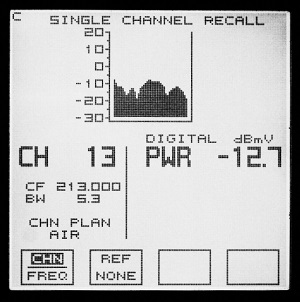

Using the Emitor DigiAir Pro ATSC meter, channel 3 yields a 58 dBuV signal strength. However, the BER and SNR readings will not lock.

This signal will not lock because of too many errors (high BER) even though it is fairly strong; -12.7 dBmV = 47.3 dBµV.
A 58 dBµV signal is strong. Are you using an amp?

Unfortunately, your DigiAir meter isn't going to be able to do much for you since you really need to be able to see the spectrum with a much narrower bandwidth around channel 3. It appears to only allow a spectrum display of its full channel span.
