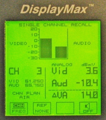

Setup: for Test 1, Part A:
Antenna > variable attenuator > splitter > tuner and SLM, with preamp #1 before the SLM; no preamp before the tuner
A strong local signal on CH33 was used, because it was fairly stable and had a good SNR before attenuation to make it a weak test signal . CH32 was vacant and was used for the noise floor measurement. The signal level meter (SLM) was set to make a single frequency measurement near center channel in the analog mode. (Digital TV signals, 8VSB-AM, are actually analog signals that carry digital information.) In that mode, it is sensitive down to -35 dBmV (-84 dBm), and the measurement bandwidth is 280 kHz.
I added a 30 dB preamp to increase the meter sensitivity to below -106 dBm. The gain of the preamp was verified with the signal level meter and a stable signal from a Blonder Tongue modulator. The linearity of the SLM was checked with fixed attenuators. The SLM has an internal noise standard, traceable to NIST, which the meter uses to check calibration at fixed intervals.
The noise floor of the measurement system was then -112 dBm.

SS is Signal Strength
E is uncorrected errors
P is pixelation
F is picture freeze
Conv#1  conversion to dBm factor is -79 dB
Correct to DTV dBm factor is +5 dB
Conv#2  conversion to dBm factor is also -79 dB
Conv#1 factor is -79 dB; 30 dB to subtract the preamp gain, and 49 dB for dBmV to dBm conversion.
Correct to DTV factor is +5 dB. According to the designer of the meter, Rob Bredin, it adds a nominal 6.8 dB for the digital single channel scan, but not for the single frequency analog measurement used above. The actual value depends upon the shape of the signal. The analog measurement for channel 33 was -11 dBmV and -6 dBmV for digital, a difference of 5 dB.
Conv#2 factor is also -79 dB to convert from dBmV to dBm for the measuring system noise floor.
C/N is the ratio of the signal from the antenna to the measurement system noise floor to differentiate it from the TV SNR.
SLMs are calibrated in dBmV and used by antenna installers and cable techs. It was necessary to convert to dBm to match a TVFool signal report
With the attenuator at 26 dB, the SNR was 15 dB for a -85 dBm signal, just where you would expect it to be with a tuner NF of 6 dB. A signal power of -85 dBm is 6 dB above the minimum required signal strength of -91 dBm, which is 15 dB above the -106 dBm noise floor for a 6 MHz bandwidth DTV signal.

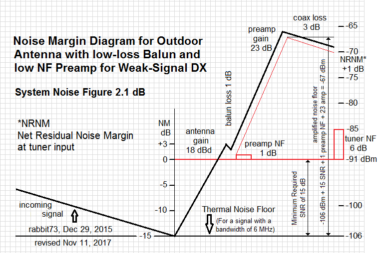

CONCLUSION:
It is not possible to receive and decode 8VSB OTA signals with an accurate listed NM below -15 dB at -91 dBm. Even though a narrowband measurement shows sufficient C/N for a SNR of the signal to noise floor at the antenna output, the noise floor for a signal with a bandwidth of 6 MHZ is -106 dBm. Even without a signal present, the intrinsic noise power in a 6 MHz bandwidth is -106 dBm. Any digital TV signal that is weaker than -91 dBm, will have an SNR less than 15 dB, and can not be decoded.
As you can see, there was additional SNR available at the antenna that could not be utilized by the tuner because of the fixed noise floor of -106 dBm for a 6 MHz bandwidth signal.

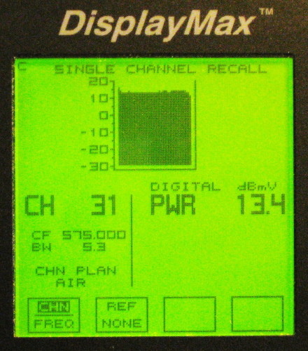

A second test was made using the digital mode of the Sadelco DisplayMax Signal Level Meter (SLM). In this mode, the meter is sensitive down to -20 dBmV (-69 dBm). I added two preamps in series before the SLM:
Antenna > Variable attenuator > splitter > tuner and SLM with two preamps in series before the meter; no preamp for the tuner
splitter > CM7777HD 30 dB > CM7777HD 17 dB > SLM
The combined preamp gain, as measured, is 47 dB. This puts the measurement system noise floor at -67 dBmV (-116 dBm), but is limited to -106 dBm because the measurement bandwidth is ~ 6 MHz when measuring a signal in the digital single channel scan mode.
I measured the noise floor of the measurement system with the meter set to CH 33, but no signal connected to the input of the first preamp; without and with a 75 ohm terminator on the input:
Meter set to analog measurement, video carrier frequency of 585.250 MHz, 280 kHz bandwidth:
-18 dBmV - 47 dB preamp gains - 49 dB convert to dBm = -114 dBm
With 75 ohm terminator on input of first preamp:
-14.9 dBmV - 47 dB preamp gains - 49 dB convert to dBm = -110.9 dBm
Meter set to digital measurement, 6 MHz channel scan:
-12.6 dBmV - 47 dB preamp gains - 49 dB convert to dBm = -108.6 dBm
-10.3 dBmV -47 dB preamp gains -49 dB convert to dBm = -106.3 dBm
Meter set to digital measurement, single frequency center channel 587.000 MHz, 280 kHz bandwidth:
-18 dBmV - 47 dB preamp gains - 49 dB convert to dBm = -114 dBm (114 - 108.6 = 5.4 dB difference, digital to single frequency)
-14.7 dBmV - 47 dB preamp gains - 49 dB convert to dBm = -110.7 dBm
CH33 was again used for the test signal. Vacant second adjacent CH35 was used for the noise floor measurement; there was too much spill-over from CH33 into CH34 with two preamps in series.
F is picture freeze
Conv#1 conversion to dBm factor is -96 dB
Correct to DTV dBm factor not needed
Conv#2 conversion to dBm factor is also -96 dB
This test confirms the conclusion of Test 1.
OTA 8VSB signals weaker than -91 dBm can not be received and decoded using additional antenna gain. The noise floor for a 6 MHz bandwidth signal is fixed at -106 dBm. This noise power exists in a 6 MHz channel even when there is no signal.
Signals weaker than an accurate NM -15 dB on a TVFool report will have an SNR less than 15 dB, and can not be decoded.
Additional antenna gain can improve the SNR of a weak signal, which is something a preamp can not do. But, if the signal is still weaker than -91 dBm, the additional antenna gain is of no benefit.

After reviewing my measurements, I see that they might not provide sufficient proof to support my conclusions.
The main deficiency is the noise floor of the measurement system; it isn't low enough. I need to find a way to reduce it, perhaps with a preamp for the meter that has a lower NF.
The C/N ratio of the signal at the antenna terminals is not enough to be greater than the difference between the input of the tuner of -85 dBm and the thermal noise floor at -106 dBm, when a preamp isn't being used.
106 - 85 = 21
This makes it unclear if it is possible to receive and decode a signal with a NM below -15 dB.
I'm looking for an equipment setup that can prove it either way, but I haven't found it yet. Maybe I need to include a preamp for the tuner also.
