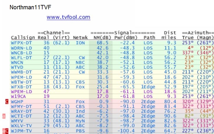

Below is my tvfool report for my current home. Any suggestions for direction and antenna would be greatly appreciated:

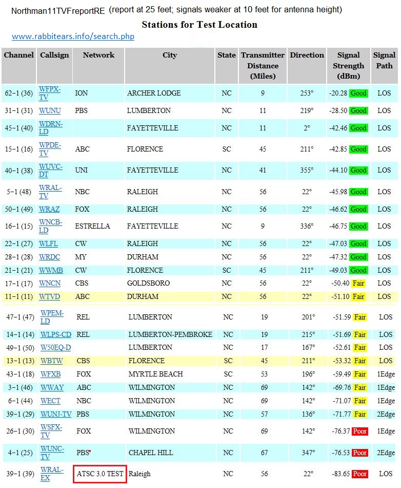

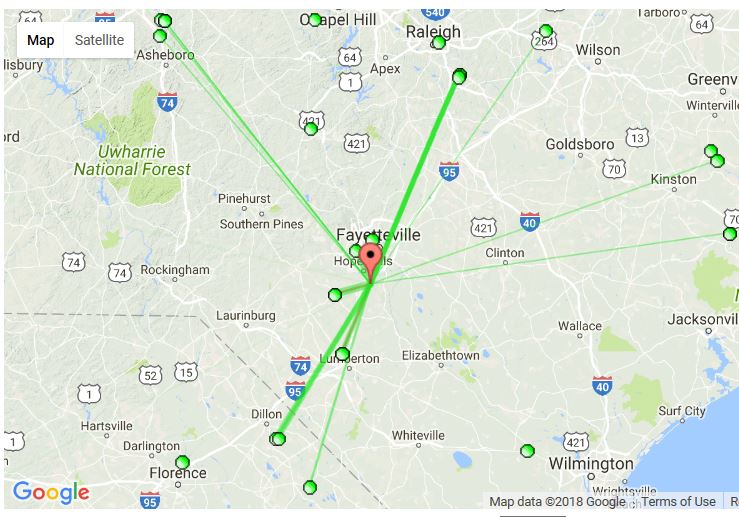

The antenna will be located inside the house. Ideally I would like to get the typical local stations (CBS, ABC, NBC, FOX).

Inside is not a good antenna location for your signals. Attic would be a little better; outside would be best.
You will need to do some experiments to see what you can get.
Try an Antennas Direct DB4e UHF antenna aimed at 32 degrees magnetic. Add a preamp if necessary.
WTVD ABC will require a VHF antenna added to the DB4e with a UVSJ UHF/VHF combiner, or switch to a UHF/VHF combo antenna like the Winegard HD7694P:
http://www.newark.com/stellar-labs/3...vhf/dp/48Y8141

If that doesn't work, try the attic.
If that doesn't work, move the antenna outside.
That's the best I can do without seeing a satellite view of your location. If you desire, you can give me your coordinates or address in a PM.
Interesting note: WRAL is doing ATSC 3.0 tests on real channel 39.
WRAL on 48 will move to channel 17 because of UHF Repack:
https://rabbitears.info//market.php?...&callsign=wral
WRAZ will move to 15:
https://rabbitears.info//market.php?...&callsign=wraz
WNCN will move to VHF-High channel 8:
https://rabbitears.info//market.php?...&callsign=wncn
You will need to switch to a UHF/VHF combo antenna or add a VHF antenna to the DB4e with a UVSJ UHF/VHF combiner.
