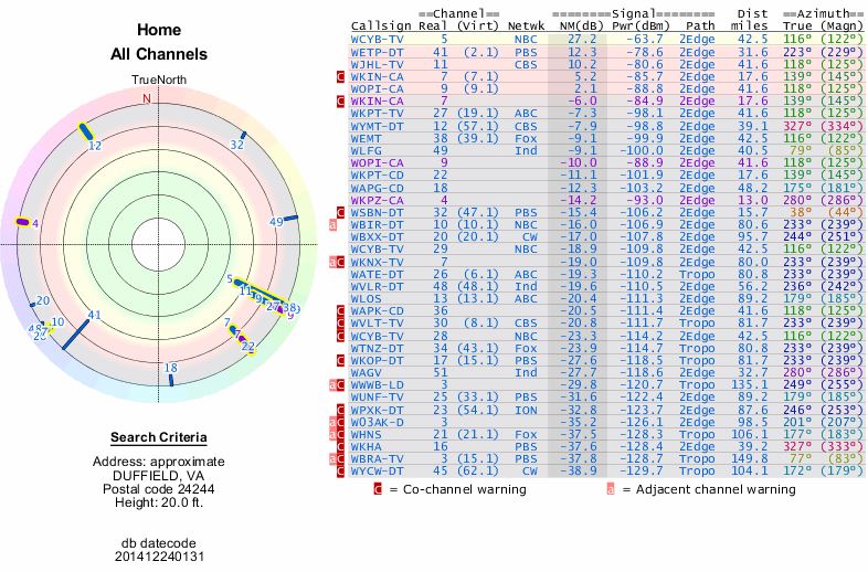

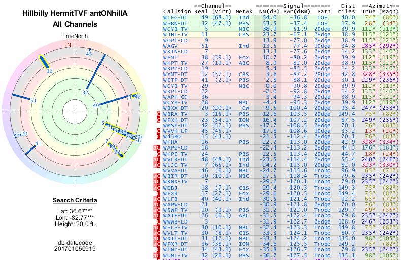

This is the image report that you gave in your previous thread:

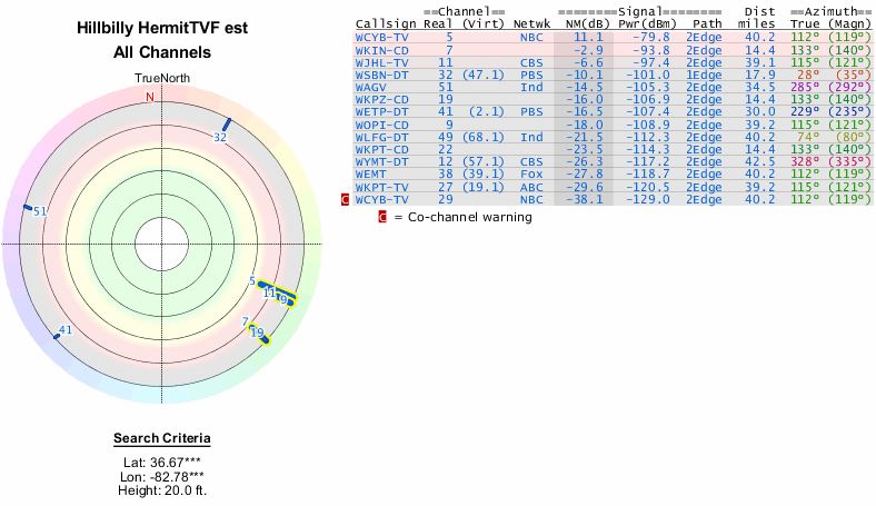

Thanks for the signal report image for this new thread. I see that you have entered an antenna height of 500 feet. Do have a 500 ft tower at 1401?
This is a report at 20 feet based on the 1401 location in your image:
http://www.tvfool.com/?option=com_wr...e6a49b16d0a52d

your report at 50 feet
http://www.tvfool.com/?option=com_wr...e6a42d0ed01454

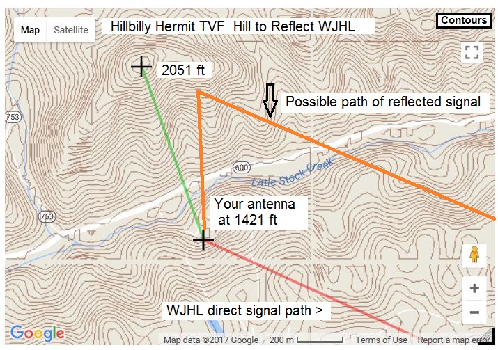

If I cannot get direct signals, I am hoping that maybe I can get reflected signals.
You might be able to receive WCYB and WJHL directly or from a reflection off the hill just north of the highway with the big Solid Signal HD8200XL antenna and a preamp.

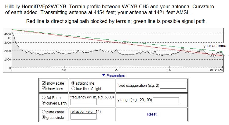

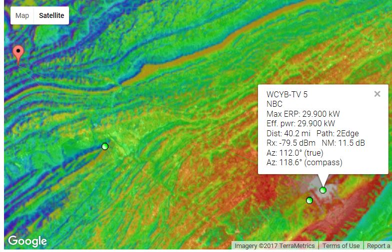

Old 30-Sep-2017, 7:02 PM   #9

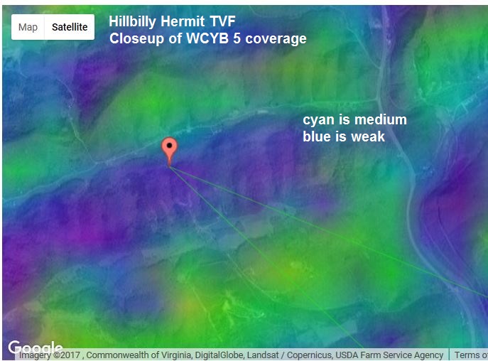

This shows the hill just south of your location that blocks the WCYB 5 signal:
The WCYB signal coverage is very spotty in rough terrain:

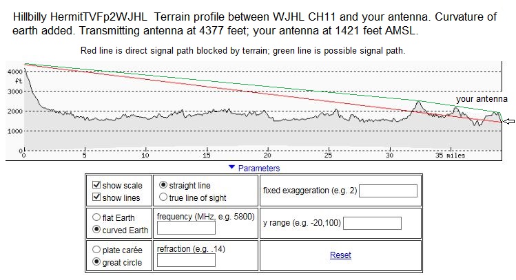

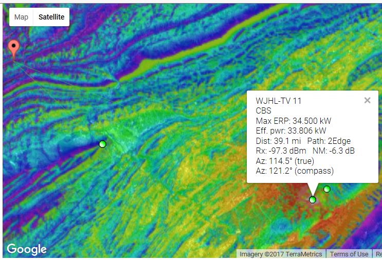

Old 30-Sep-2017, 7:32 PM   #10
The hill also blocks WJHL:
WJHL is weaker than WCYB:

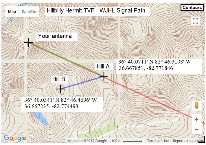

Old 30-Sep-2017, 9:08 PM   #11

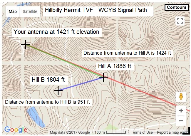

This is a contour map of the WCYB signal path and two hills:
WJHL signal path with hill coordinates:
Old 1-Oct-2017, 1:59 AM   #12

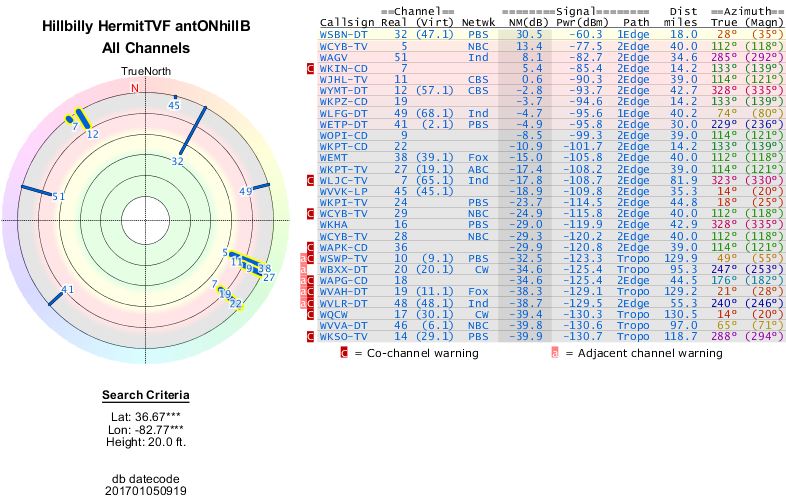

TVFool report if your antenna is on Hill A:
http://www.tvfool.com/?option=com_wr...e6a48f7776b0d9
TVFool report if your antenna is on Hill B, which is closer to your house. The signals aren't as strong as on Hill A, but stronger than at your house:
http://www.tvfool.com/?option=com_wr...e6a4f2c4f2f960

Oblique view looking North, showing your location and Hills A and B:
