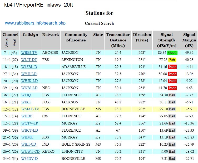

My inlaws currently get ABC and CBS which is part time MEtv and PBS on virtual 7.1 7.3 and 11.1-3 with indoor amped antennae. The aim is to get real 16 virt 39.1 for NBC/CW and real 39 vir 16.1 for Fox etc. (yes , I know the 16 and 39 s are confusing but thats what it is 1 real and 1 virtual each) The TV Fool report is as follows
:http://www.tvfool.com/?option=com_wr...9038abf92c6241
this is for 20 feet.
I set up a Televes LR temporarily because I had it at 14 feet with clear unobstructed acces for at least 1/2mile to a hill of similar height at 280 degrees and also tried 260 and 270 degrees.
We added real 27 which is also vir 27.1-7 this is a big plus with all the channels like Get tv ,decades ,Hand I, antennae tv, Cozi, Bounce etc.
I would expect to get the NBC real 16 since its similar in strength to the 27 but I do not. As expected 39 real is not received .
Now do you think it is worth trying the 91 XG either single or stacked at about 20 feet to try for NBC real 16 and probably not real 39 ?

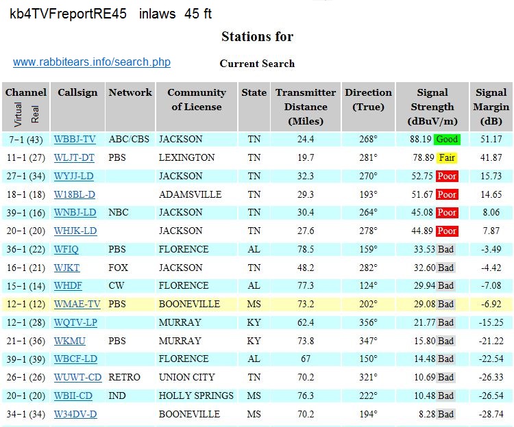

I realize We could go to 45 feet or a little above and almost assuredly get real 16 and 39. Follows a report at 30 feet:
http://www.tvfool.com/?option=com_wr...9038ee94e23f31
the following is a report at 45 feet:
http://www.tvfool.com/?option=com_wr...9038bf673538f2
Do you think 45 feet is high enough for reception of real 39 ?
Do you think 30 with stacked 91 xg is enough at 30 feet ?
Any suggestions of any other antennas or combos etc would be appreciated.

Hello, kb4. There are some errors in the TVfool report because of a defective database and many recent channel changes because of Repack by the FCC.
A report from rabbitears.info has a more accurate list of channels.
WJKT Fox is now on real channel 21.
https://www.rabbitears.info/market.p...&callsign=WJKT
WJKT Fox is now real 21, not 39.
The signal report is only a computer simulation. I suggest you try the 91XG at 20 feet for 16 and 21 with a preamp. It sometimes helps to tilt the front end of the antenna up. Also note that those two channels are about 18 degrees apart, and will be scattered by diffraction at the terrain peaks.
If that doesn't work, try a single 91XG at 45 feet.
Horizontal stacking two 91XGs at 45 feet is a last resort. It's a lot of work and will make the beamwidth more narrow.

I appreciate the detailed response . I knew there was a pretty high ridge between transmitter and antennae wasn't quite sure if its height was high enough to block the height of the transmitter. I am afraid that to get Fox will have to go to 45 feet or so but most likely will be able to get NBC at 20 feet. I plan to try the current televes at 20 to see what NBC does then if don't get NBC get the 91XG and try it at 20. If either gets NBC will likely stop for now and see if can find a nearby tower not being used to take down and move to their location. I don't really like using 40 ft push up etc but had a stardust and big stick on one on chimney mount long time ago. There are many towers that are not being used in this area and probably could get by with 30 foot tower and 20 foot galvanized chain link fence rail up additional 15 feet or so or schedule 40 water pipe.

well went to the inlays today and moved the antenna up to 18 feet and NBC came in then went to 22 feet and fox came in. so they now receive ABC CBS NBC FOX CW and 13 other rerun type channels reliably. That is what we were hoping for and early ams and night sometimes they get two channels from memphis via tropo .
I was using the military type aluminum tent poles that i drilled holes in and placed pins through like a boat trailer safety pin and a triangular pod stand often used for temporary radio transmitter antennas . Next is the permanent pole, cable burying etc. I intend to get a twenty foot pipe and pivot it on an old satellite c band antenna pole that is concreted securely in place . this will make it easily accessible. and get it up an extra 2 feet or so.
Maybe the Televes antenna does well here because of the angle of the triple booms line up with the refraction angle off the ridge a few miles away.
Thanks for the help and suggestions and I learned to use rabbit ears.com also!
