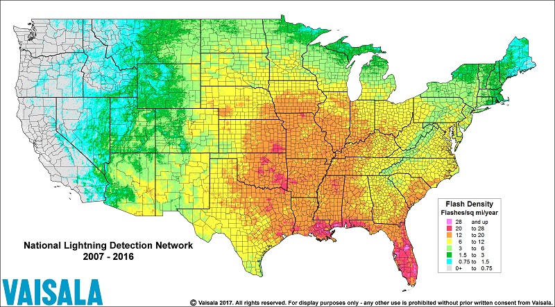

Old 7-Jul-2017, 3:34 PM   #7
Satellite System Grounding
Part 2 - NEC Overview
Presented by Todd Humphrey
Todd Humphrey doesn't speak for the NFPA that publishes the NEC code, but he has some ideas that are helpful. The local electrical inspector (AHJ, authority having jurisdiction) has the final say if you are willing to get him involved. Some inspectors are more friendly than others; a local electrician could tell you.
