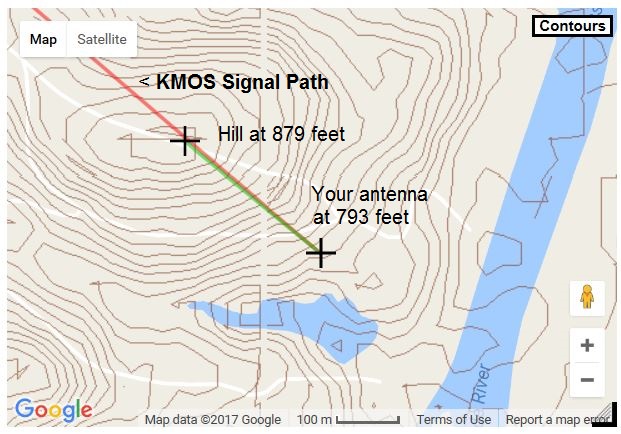

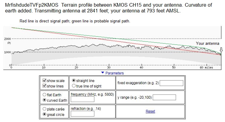

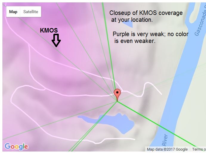

That is a difficult location for TV reception.
The first four channels are off the air according to rabbit ears.info, so the next channel is PBS. The curvature of the earth blocks the direct signal:
And, if my estimate of your location is correct, you are down the hill near the river.

I have three suggestions to improve your odds.
1. Select an antenna that has more gain than most for CH 15. As implied by ADTech, they can vary a lot at the low end of UHF.
2. Tilt the front of the antenna up to catch the signal coming down from the ridge.

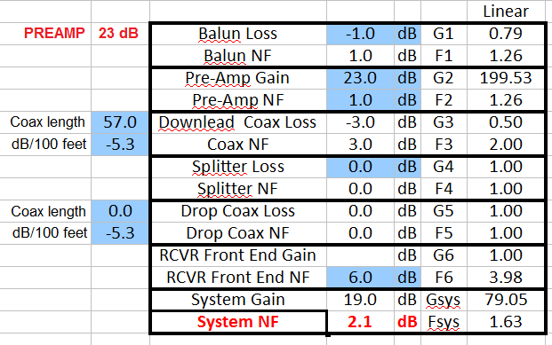

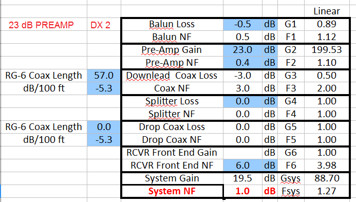

It is impossible to receive signals weaker than NM -15 dB because they are buried in the Thermal Noise Floor below -106 dBm. If you are able to receive channels listed below -15 dB NM, either the tvfool report is wrong or the signal has been enhanced by Tropospheric Propagation.
Here is the System Noise Figure calculation for the above diagram:
You can do a little better if you use a preamp with a lower noise figure and a lower loss balun:
Yes, the KT-200 would also be my choice. Keep in mind that the ultra low noise preamps are more sensitive to static damage; that's the trade-off. The Antennas Direct PA-18 might be a good compromise design for your location, but you haven't told us which CM preamp you are using.

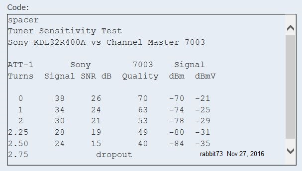

Lately, I have been doing experiments with indoor antennas, which are the only option for some people. This is the diagnostics screen for my KDL32R400A. I have added notes and a picture of the antenna.
In order to test for tuner sensitivity, I hook up two tuners with a splitter and a variable attenuator. I then increase the attenuation to see which tuner drops out last, making it the winner. The test can be made with or without a preamp, as long as the attenuator is after the power inserter if a preamp is being used.
Ant > coax > variable attenuator > fixed attenuator > splitter > tuners
The value of the fixed attenuator depends upon the strength of the signal. I use a fairly strong stable signal for testing. Sometimes a 20 dB fixed, sometimes a fixed 10 dB, and sometimes both.
http://mjsales.net/collections/atten...ant=1083705673
Attenuation values 1, 3, 6, 8, 10, 12, 16, 20dB (FAM)
click on 1 dB for other values; the up and down arrows are faint
The most recent tuner sensitivity test that I have done was to compare the CM7003 STB tuner with my Sony KDL32R400A that I had calibrated for signal strength with my signal level meter (SLM). But, you can make the test without knowing the absolute values for signal strength.
The ATT-1 knob has 3-3/4 turns, so I put a mark on the knob with an ultra fine point Sharpie to count the turns. Clockwise rotation increases the signal; minimum attenuation at full clockwise rotation. I started there, and rotated the knob counterclockwise to increase the attenuation for the test.
I used the WTKR CBS, RF 40, virtual 3.1 signal for the test. It wasn't as stable as an LOS signal that I usually use because of trees, but it was what was available for the test.
These are the readings:
Dropout was at about -85 dBm, where you would expect it to be.
Thermal Noise Floor -106 dBm + 15 dB SNR = -91 dBm
and then adding tuner Noise Figure:
-91 dBm + 6 dB Tuner NF = -85 dBm
The CM7003 tuner is about as sensitive as the Sony, which is good, but the 7003 remote control isn't very responsive. The aim is critical and sometimes it is necessary to push a button more than once. I bought a Sony RM-VLZ620 Learning Remote and taught it some of the basic buttons on the CM-7003 remote. The box is much more responsive to the Sony remote.
