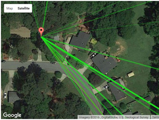

I looked at an aerial photo of your location. The green signal lines miss the trees across the street, but I'm worried about the trees in front of your house.
Is it possible to install the antenna with a telescopic mast?
Yes, a telescopic mast can work if the antenna is located where it can "see" between the trees and below the branches in front of your house. Trees block TV signals.

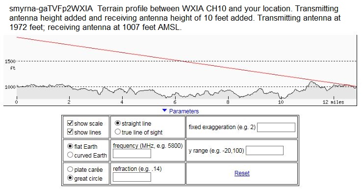

You can see the terrain profile between a transmitter and your location if you click on its callsign in your report. The transmitter is on the left, and your location is on the right.
WXIA NBC
http://www.tvfool.com/?option=com_wr...dALLTV%26n%3d3
WSB ABC
http://www.tvfool.com/?option=com_wr...ALLTV%26n%3d10
The signals skim the last hill.
That hill doesn't look too serious; I'm more concerned about the trees.

This photo shows the green signal lines from the SE. They clear the trees across the street, but I'm worried about a clear path through the trees in front of your house. You might have to trim some branches.
