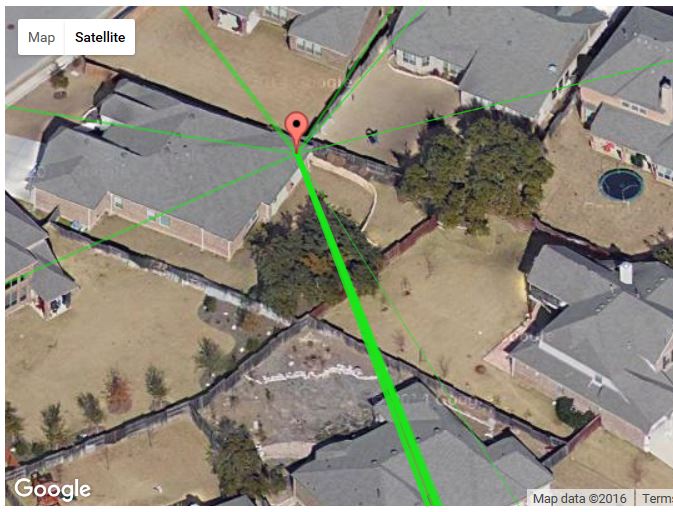

Here is my TVFool signal analysis result.
And here is the antenna I'm using (an RCA ANT751 Yagi).
Here are some pictures of the antenna mounted on my roof:
basic antenna setup
view from antenna's perspective, pointing at Austin towers
The antenna does "look through" a relatively large oak tree in my yard, as you can see from the second picture.
To verify reception issues with just this one channel, I viewed each channel for 5 minutes or so, noting no reception problems on any station except for KVUE. Also, I ran a low-level network packet loss test, which also tests for reception issues (documented here), and this test indicated no reception errors on any channels except for KVUE. There was no network packet loss, only loss due to signal reception.
The only root cause I can come up with is interference (from the tree?), but I'd appreciate others' opinions, and I'd especially appreciate suggestions for removing the issue.

Is it possible the oak tree in my yard is interfering enough to degrade reception? The tree is ~40 feet from the antenna, and the antenna must point through it to aim at the Austin towers. I'm trying to determine whether or not I should try to move my antenna higher on my roof to aim around the trees. I suppose I could just try it and see...
I'd recommend simply 1) moving the antenna so it's not right on the metal gutter and 2) move it so it isn't staring point blank into a tree. Both are commonly encountered but less obvious installation errors.
Proximity to large metal surface causes interference with anticipated antenna patterns and can, if the proximity is just wrong, act as a trap for a specific frequency.
Trees can cause unpredictable results and can cause dead spots for specific frequencies for a very specific location in the spatial environment behind the tree. With UHF wavelengths, moving the antenna by as little as 6" can move a receiving antenna either into or out of these highly localized dead zones. FWIW, I'm going to blame it on the tree until any other factor surfaces.
You do not need a different antenna, you just need to use the one you have more effectively.

Your intuition is excellent. Trees block TV signals.
scroll down to Trees and UHF
