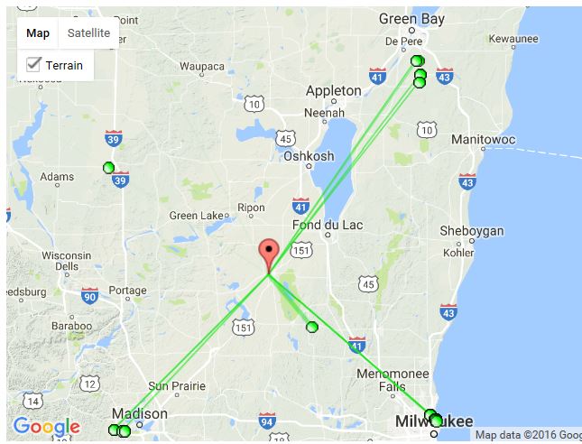

Madison looks like the better direction if there are no trees or buildings in the signal path.
I have a short ranch style house and one 2 story brick house right behind me that may or may not be issue.
Which way is behind you? I would need to look at a satellite view of your house with the green signal lines to see obstructions.
You will need a UHF antenna with more gain than the ones you have mentioned and a preamp for your 2Edge signals.
Consider the Antennas Direct DB8e, 91XG, and Solid Signal HDB91X.
For preamps, consider the Antennas Direct Juice, Channel Master 7778, and the less expensive RCA TVPRAMP1R.
Unsure on grounding block tho but will come through the bottom of the current exterior cable box into the house and follow the current cable internet coax wires.
You can't have internet and OTA on the same coax.
I'm attaching a 6ft piece of 2" galvanized exhaust pipe
That diameter might be too big for some antennas; 1-1/4 or 1-1/2 is more common. Double check it.

My house is on the south west part of town.
Madison channels is what I'm hoping for. There are about 10 or so houses within 1/2 mile of me that will be directly blocking or close and some trees here and there. I would need a huge tower to get above them and I'm not willing to do that or spend that much. I'm hoping to keep it under $100.
The brick house behind me is exactly facing madison direction. I'm not 100% sure on exact direction but my mounting spot may allow it pointed be teen their house and their detached garage. I need to get a compass or something with exact degrees on it. Unless there's a better way?

You can get a very good idea by using the interactive/online mapping tool. Switch over to satellite view, turn on the green lines, and then zoom and pan as needed. With the green lines, you can easily visualize the signal path back to Madison and see which antenna placement location offers the best available path.

The suggestion by ADTech is a good one.
How to use the TVFOOL Interactive Map Browser
To select the best location for your antenna, you need to use the tvfool interactive map browser and move the cursor, by drag and drop, to your antenna location. Enter the antenna height. As you move the cursor, you will see the coordinates change to follow the cursor.
As you zoom in, you can choose map or satellite view. You can turn on the green signal lines. In satellite view you can sometimes choose vertical view or bird's eye view. You can turn off the street names (Labels) to protect your identity, if the image is shown in a post.
If you have a problem with the map browser, you can give me your address or the coordinates of your antenna in a PM (Private Forum Message) and I can generate the map.
