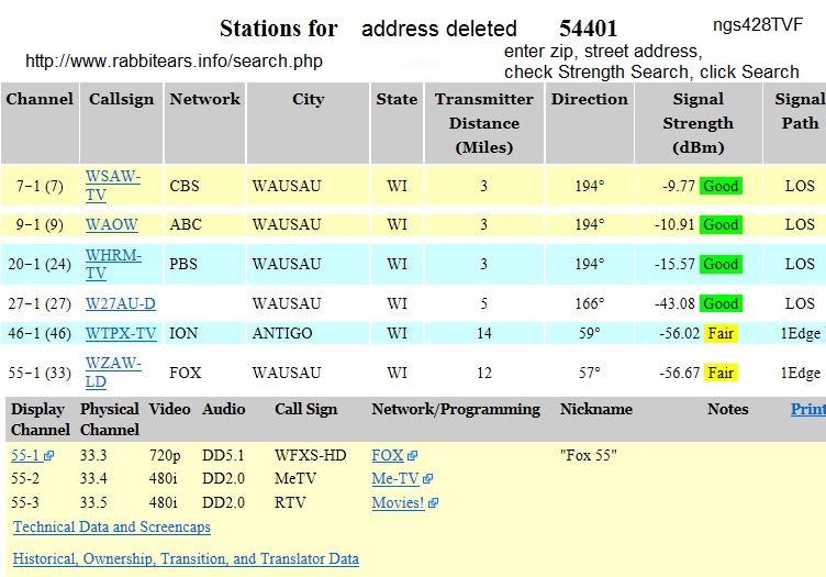

Old 20-Sep-2016, 2:07 AM   #14
You are correct, WZAW doesn't show on the tvfool report, but it does show on a rabbitears.info search. The tvfool website is short on people to do updates.
rabbitears search
http://www.rabbitears.info/search.php
What you get is a lot like a tvfool report with the channels listed in decreasing order of strength.
WZAW is about 15 dB weaker, so you need an antenna with more gain aimed directly at it.
Old 20-Sep-2016, 3:09 AM   #15
ngs428
Join Date: Sep 2015
Posts: 9
Thanks for the reply Rabbit73. My 2 weakest channels (27 and 33) are 108 degrees apart. Seems as though I would need an antenna not as directional as my Clearstream 2v.
Odd thing is, when I point my 2v antenna directly at WZAW 33 it actually comes in worse than my current setup where I have it aimed directly at channel 27.
Thoughts on some good high gain antenna options? Thanks again!
