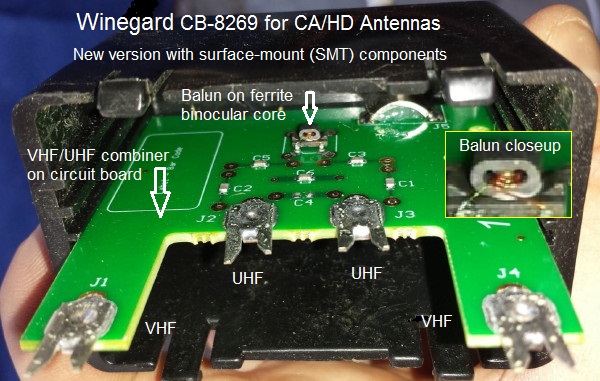

Yes, you should. The Esky with an internal preamp works, so the 7698 with the LNA200 should also work.
The 7698 has an internal balun; it doesn't need an external balun. Winegard has a troubleshooting video:
https://www.youtube.com/watch?v=TlQk...ule1MX8jCAfvPQ
