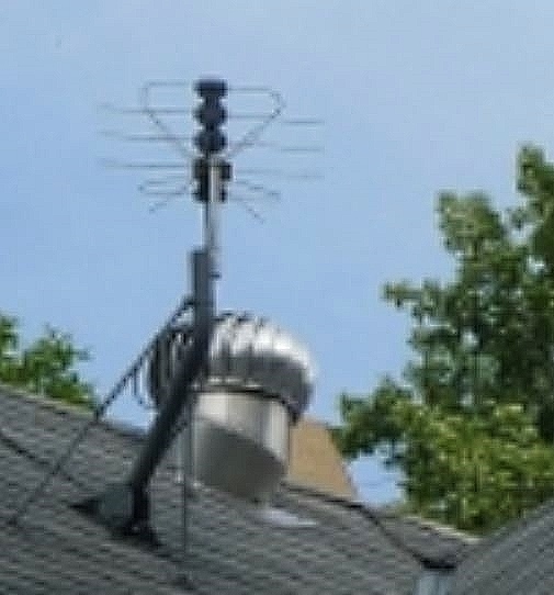

Thanks so much for the input! I wanted to follow up with some pictures we took of the antenna as well as sort of our view toward the NE where the towers are.
Does the antenna look familiar? Does it look poorly-sited, meaning it should be up higher? Imagine it's very hard to tell given the weird perspective of a photo taken from ground level. I'll look for grounding but suspect it's unlikely. Does that impact reception, or is this more of a safety issue?
We do have plenty of trees--fortunately or not, the one immediately in the way is an elm so I'm planning for sunshine sometime in the future, poor thing.
Whether there are tall buildings on the signal path or not--I'm not sure, but I'd assume so. It's all suburban Minneapolis from us to the towers, so at least the tallest buildings aren't in the way (downtown is to our south), a few senior high rises or similar are probably between us and the towers.

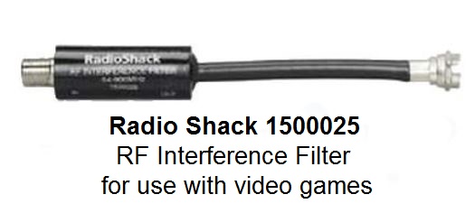

The radio interference filter I got was the RadioShack 1500025--says it eliminates radio interference: Rejection 0~25MHz/30dB, 25~30MHz/35dB. Should I try something else?

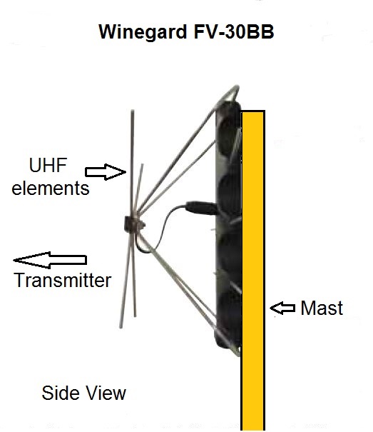

Thank you for the photos, Erin. The antenna looks like the Winegard FV-30BB.
It looks like the lower loop is out of position, but it is probably just the angle that the photo was taken. If the camera was facing NE, then the horizontal reflector rods at the rear of the antenna should be facing the camera and the X UHF elements should be facing NE. Interestingly, the instructions for the antenna don't tell you which is the front of the antenna, but by convention an antenna photo by the manufacturer shows the front.
http://www.winegard.com/help/images/8/80/2452285.pdf
I see a large metal vent in front of the antenna, an object and tree beyond the vent, and possibly the antenna is below the peak of the roof; not an ideal site.

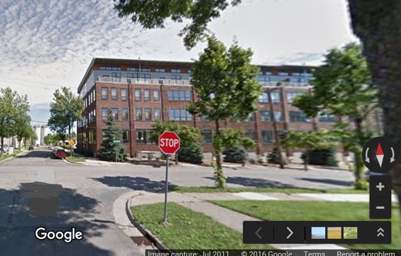

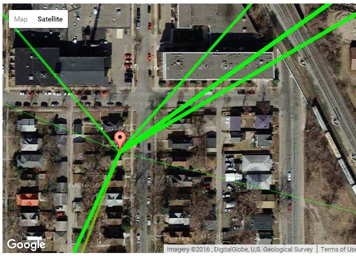

The street photo shows a large building in the signal path if my guess of your location is correct. If my guess is way off, maybe you can correct me in a PM, and I will redo the image with the green signal lines.
When I looked at your report, I also thought overload, but I agree with Steve; objects in the signal path.
Yes, you should try something else. That filter is used to keep interference out of a video line when you are using a video game, like the Atari 2600. The RS FM trap is 1500024 or the older 15-577, both of which are hard to find. The Antennas Direct FM Trap is available.
The problem with those filters is they don't cover the whole FM band well, and you have strong FM signals across the whole FM band, but you could put two in series for more rejection if needed.
http://www.fmfool.com/modeling/tmp/8...f/Radar-FM.png
A HLSJ (high and common ports) can be used as an FM filter if you need one. NBC and Fox are the channels most likely to be affected.

If the antenna can be mounted in the clear with no local objects in front of it, then the only thing left to block the signals is the large building; the reception should be better.

It also looks like it's not clearing the top of the roof line and by not being very tall mast it could be getting a signal bounce off the roof which can cause problems, (sometimes it helps too).
I'd look at getting it up higher and free and clear of all the obstacles you can. You could go with a gable end mounting at the peak and get another 10 feet over the ridge line. Also lets you choose a different side of the house to mount it on to help get from behind trees, etc.
