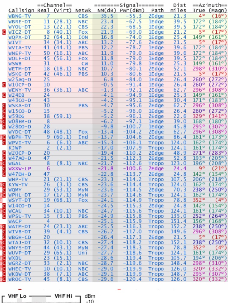

I am trying to help a friend choose an ota antenna. I have attached the report. Trying to get the channels at 172 degrees and 39.5 miles away. Thx in advance for any help. Chris

He said in his first post
That will require a VHF-High/UHF combo antenna aimed at 184 degrees magnetic and maybe a preamp.

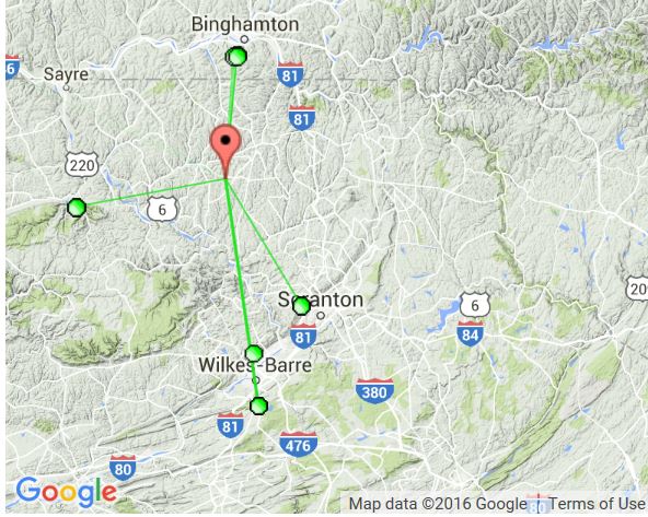

Ok I did get better reading using interactive map. That was unbelievable being able to see the house get exact location. Would most likely get channels out of Scranton now that I think of it more. Mostly because they want to get football games for the Eagles. Not sure if NY would show but not sure what would work. Also not oppose to multiple antennas if that works with combiner. Thanks again for all info and learning something new.

Thanks for the new more accurate report. The signals are a lot weaker, but not impossible. It shows how a small change in location can make a big difference in the report in rough terrain.
I agree that Scranton looks promising for WBRE NBC and WYOU CBS. They are VHF-High channels. You could use a VHF-High/UHF combo antenna like the Winegard HD7698P. You can also use a VHF-High antenna, like the MCM 30-2475 or 76, for Scranton and have a UHF antenna, like the Antennas Direct 91XG, for another direction combined with a UVSJ.
You will need a preamp like the Antennas Direct Juice.
