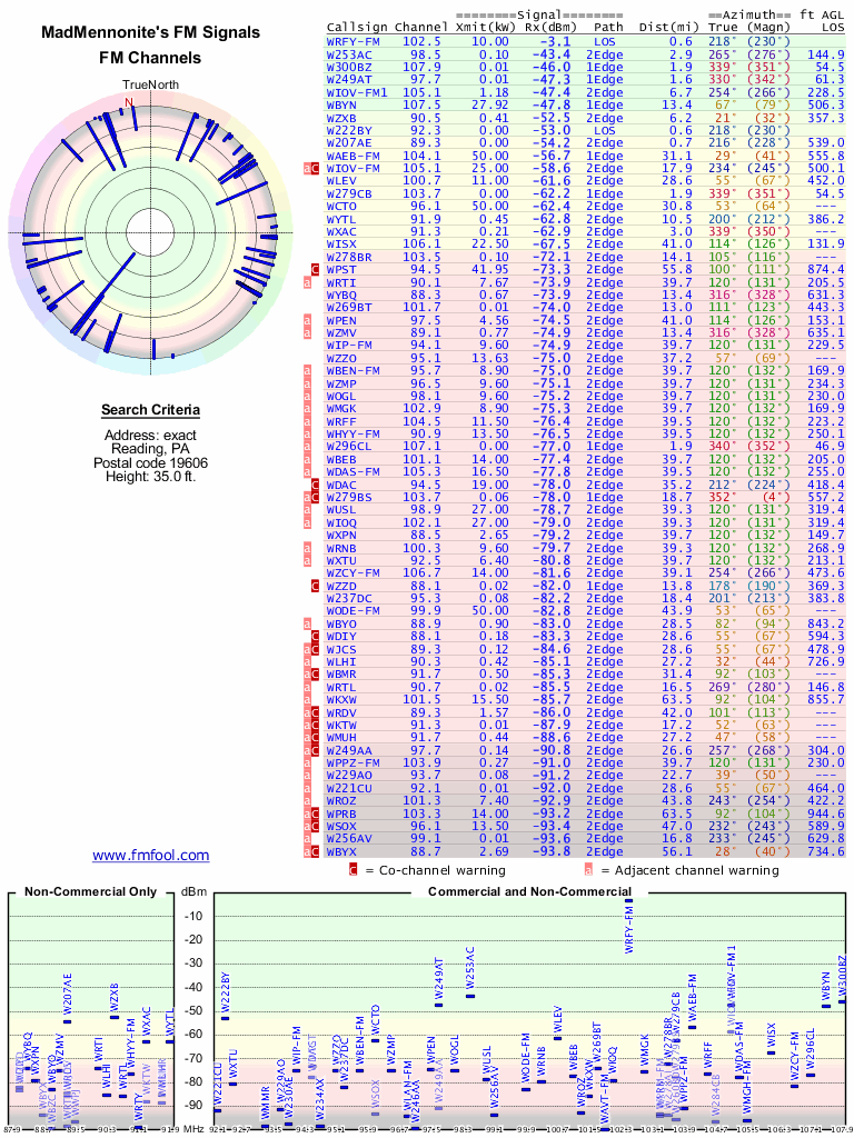

I was able to pull 37-42 channels with the CM3016 at best. I picked up an FM Trap (super cheap) from Radio Shack, and also picked up an RCA TVPRAMP1R (thanks GroundUrMast) to test results. I have a 10kw tower less than a mile from my house, and a 28kw tower 14ish miles away (see attached FM Fool image) among other things. The FM Trap didn't help a ton, as the signal attenuated a few of the weaker channels, and it did not help pull in WPVI. The RCA preamp helped pull in more sub channels (getting the really super weak Philly channels), bringing my total to around 50-52; still no WPVI (not shocked).
So, I'm debating trying a different antenna of a similar size, or trying a folded dipole cut to Ch 6 and running a duplexer or combine in to the RCA Preamp (seen from rabbit73's posts). As stated in a simple form before, roof mounting is difficult in my situation as the cleanest way to the roof and chimney requires scaffolding or an uber-long ladder from the back or front of my home, the ground on the side is on a slant. If I am destined to roof mount, I will most likely hire out.
Any suggestions on other affordable antennas to try out? Is the dipole a great idea?

Thanks for doing your FM report. It shows WRFY-FM that is about 67 dB stronger than WPVI. It is probably strong enough to overload a tuner or a preamp, but if you use an FM filter it will make WPVI weaker. The only solution I can think of is a custom notch filter designed to attenuate WRFY-FM without harming WPVI. Winegard used to make a tunable FM filter, the FT7600, but it is discontinued.

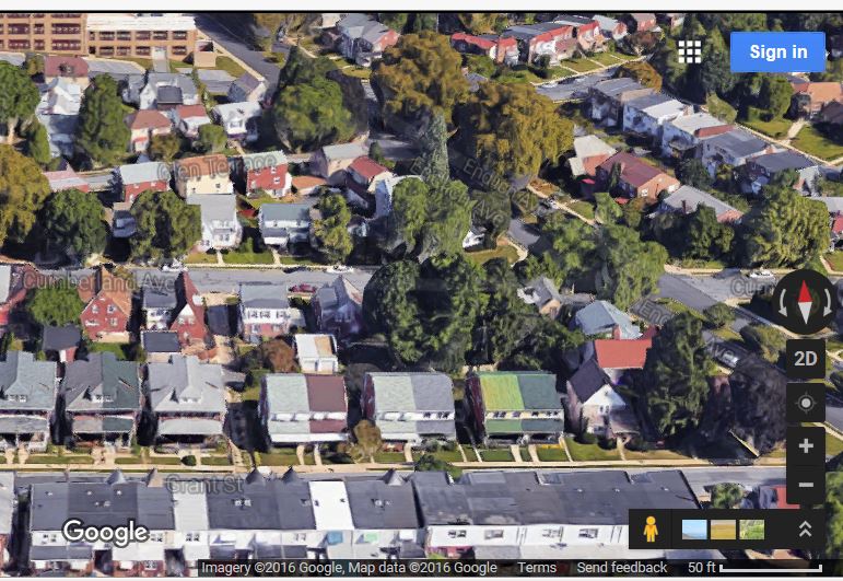

There are three other problems that might affect your reception of WPVI. The terrain profile shows that you are behind a hill for the WPVI signal:
You are in a dead zone for the WPVI signal. Red is a weak signal; no color is even weaker:
and it looks like some tall trees might be in the signal path; trees kill TV signals:

There are some trees in the path, for sure. I am in the black hole as the Langley report shows. The satellite image is right in the ballpark of where I am.
