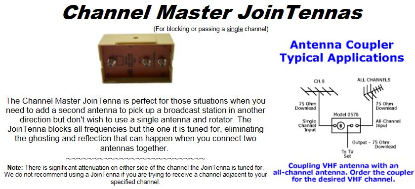

If you found a Channel Master Join-tenna for channel 11, then it is designed to do the combining for you.
http://www.channelmaster.com/JOIN_TE..._p/cm-0581.htm
What would be the best one for outside use?
The CM Join-tenna is designed to be used outside.

I want to thank rabbit73. Everything worked great . I pointed the vhf antenna at station 22 on channel 11 and got 100% signal. Ran that to the join-tenna and ran the DB8e also to the join-tenna, then to the FM filter and then to the JUICE preamp. I moved the rotor and pointed the DB8e at channel 30 and got it with a perfect picture. I did not play with it much after that , but it does work great..
