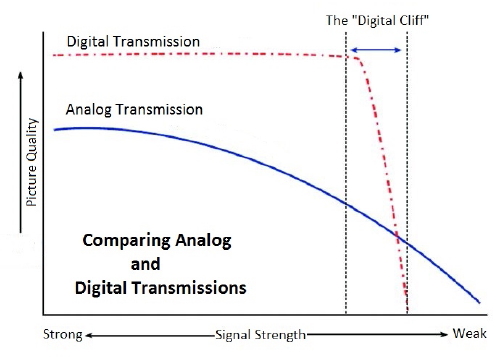

Now, my real problem: I had the antenna set up to receive the CFRN signal for a few weeks - great. Suddenly, last night, I got "No Signal" from there, but another one, CITV, Channel 13, came in very clear. Seems I can get one or the other, but not both, and always one is there.
What is happening is that the best antenna position for one channel is not the best for the other channel. If you get "No Signal" it means that the signal quality is not good enough for the TV to decode and on lock on, because the multiple reflections are causing too many errors in the digital stream to be corrected by the error correction system (FEC), and the signal falls off the "Digital Cliff" into dropout.
