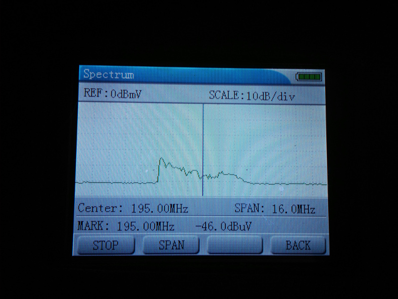

I want to get the stations from up north since that is where I'm originally from. I get everything but KOMU. KRCG comes in ok, but if I can't get KOMU I am thinking of aiming toward Fordland and getting a VHF HI antenna to aim at KRCG since KOLR doesn't want to come in for some reason and those are the only choice for CBS.
However, I would like to receive all channels from both markets if possible. I could safely put a 40' mast on the roof.
I've attached the spectrum analysis for KOMU and KRCG. The noise floor is a tad bit higher for KOMU than it is for KRCG. I think that's why I am able to get KRCG and not KOMU. I can get one for KOLR tonight.
Thanks!

Old 29-Dec-2015, 1:44 AM   #4
I don't recognize that SA display. However, the displayed noise floor is also going to be a function of the resolution bandwidth and detector type if those are available settings.

This is the analyzer:
http://www.tjjinsaixun.com/en/catego...w.asp?newid=56
I borrowed the meter, so I am not too familiar with it. It's been 15 years since I've used one. I wanted to compare the signal strength of the channels I was getting and the channels I wasn't as well as look for interference.
I don't have a preamp, but i do have an HLJS. I had a major spike at 187MHz and figured it was the 2nd harmonic of 93.5's radio station. The HLJS killed the spike. I have ~30 feet of RG6.
I have attached the KOLR analysis

Old 29-Dec-2015, 8:04 PM   #6
Thanks, never heard of that analyzer. It appears that it can only be found on Alibaba...
I'd run over to Menards in Lake Ozark and see if they have an RCA preamp on hand. it's under $25 and its good enough for testing purposes. If they're out, try the Home Depot and look for a Winegard amp. Neither rank high on my list of favorites, but they're the only ones you will likely find in a retail store at the lake (or almost anywhere else, for that matter).
Do keep the HLSJ in-circuit to fully suppress 93.5.

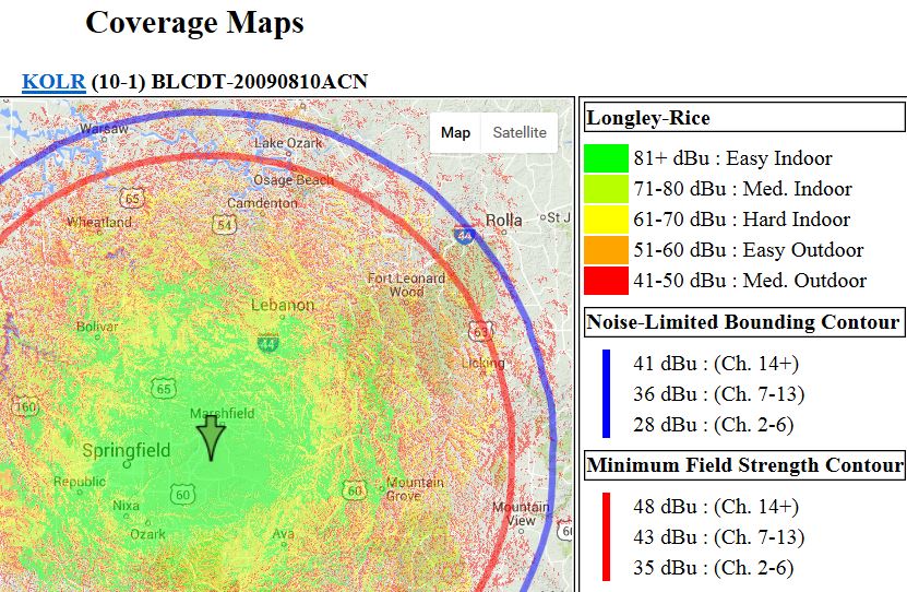

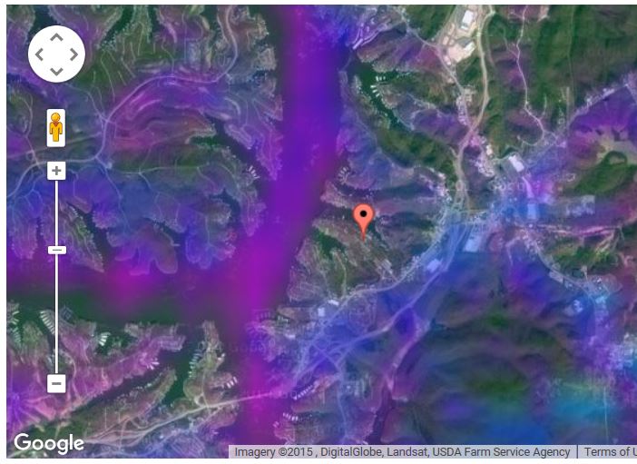

I am able to receive every LOS and edge channel with the exception of real channels 8 and 10......I had a TV up on the roof with 10 ft of RG6 and still wasn't able to receive KOMU or KOLR
KOMU at -18.3 dB NM is 3 dB below the thermal noise floor. KOLR is at the very fringe in a dead zone of the coverage map and blocked by the curvature of the earth. Your location has very rough terrain; small changes in location can make a big difference in the tvfool report. Here is the report based on my estimate of your location near the intersection of Goodfellow Ave and Procter Dr; look at the KOLR NM.
http://www.tvfool.com/?option=com_wr...b97d8f1ff9f5b9
KOLR coverage map:
http://www.rabbitears.info/contour.p...=1324294&map=Y
red spots, weak signal
no red spots, no weak signal
