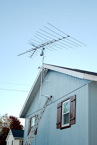

Old 26-Oct-2015, 10:33 PM   #9
NthrnNYker
Join Date: Sep 2015
Posts: 18
Well, got the mast, antenna, rotor, & pre-amp mounted on the roof -- and here is the results (oh, and I ended up mounting the pre-amp above the rotor -- I mistakenly picked up the wrong length of patch cable from the balun to the pre-amp )
http://forum.tvfool.com/attachment.p...1&d=1445898662
Now have to run the coax and the rotor control wire, and the ground block & wire ---- and it's goodbye cable box !
I'm getting to old to crawl on roofs -- my legs are STILL shaking
