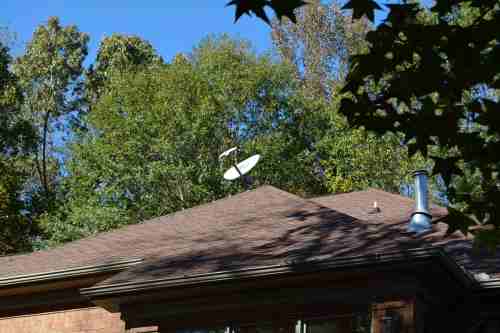

The problem I still have are trees. I have attached a picture looking at the dish from the ground, looking towards 340, and as you can see there are large trees in the line of sight. Actually my house is surrounded by trees so there is no location where I can avoid trees except for 110 degrees.

1. What are the chances that if I extend the sat stand by 3 feet and install my antenna facing about 340 that I will get 13.1 and 7.1 clearly.
2. Should I place the antenna horizontal, of face it up (I assume 45+ degrees) towards the top of the trees.

Thanks for the attic test results and the photo. The trees are pretty thick, but your signals are strong. I've seen other cases like your location work, but you will not know for sure until you test it.

It's difficult to predict. The signals will be stronger because there will not be the attic loss, but as you said the trees are still there. There is the possibility that the 7777 preamp will be overloaded if the signals are a lot stronger. Channel Master says the 7777 should not be used in strong signal areas, but the tvfool report doesn't take into consideration trees or other buildings in the signal path.

If you extend the sat stand by 3 feet it might not be stable enough for the 7698 antenna unless it has braces. You might need a different type of mount, like a tripod mount or a ground mounted mast that extends above the roof.
If you did tilt it, 45 degrees would be too much, and there is no provision for tilting the front up with the 7698. Try it horizontal first. Tilting would be a custom job.

The satellite dish mount has two braces on it. I ordered a 39 inch mount that bolts onto the satellite mount bracket. I will extend it enough to clear the roof top. I also plan to remove the dish, and LNB to reduce the weight on the mount. Do you think that is enough, or should I look at alternate methods.

I can't see how it is mounted to the roof, and I don't have enough experience to give you a reliable answer. Alternatives would be a tripod mount for the roof or a ground mounted mast fastened to the eave and side of the house with wall brackets. The tripod mount should have careful waterproofing where the screws penetrate the roof to prevent leaks; a roofers job.

I'd predict preamp overload of the 7777 in your location. Remove the preamp from the circuit and retest. Note that unplugging the preamp power supply is not a useful test.
