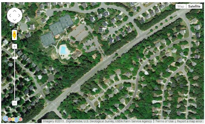

I’m in a one story house in Durham, NC, surrounded by a lot of tall trees (much taller than the house) planted closely together,

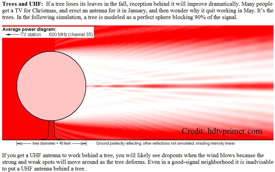

The trees are your biggest problem. Even if the antenna was outside, the trees would still be a problem. See attachment 1.
I see a lot of trees in your area. See attachment 2.
When the signals filter through the trees, it creates a multipath problem.
