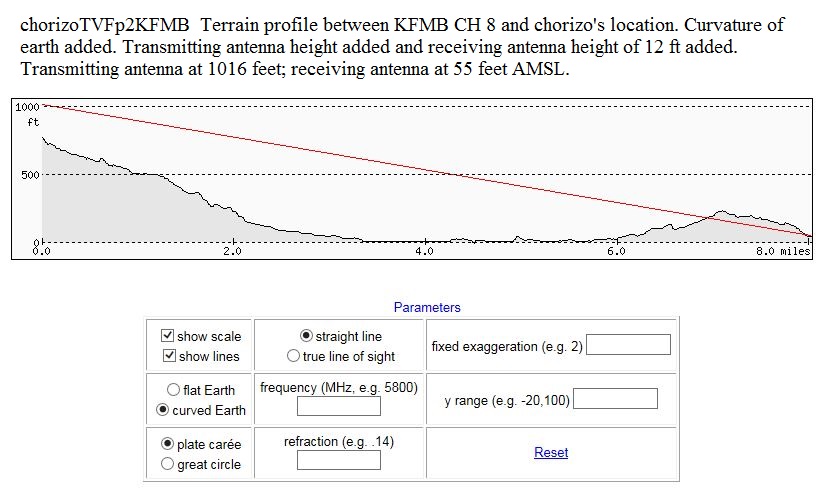

I see the hill:
And the hill is definitely in the way:
Aiming the front of the VHF antenna up a little might help.
