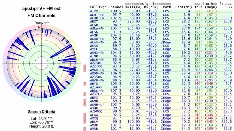

You have some strong FM signals that might interfere with TV reception; add an FM filter in the coax. See attachment 1.
