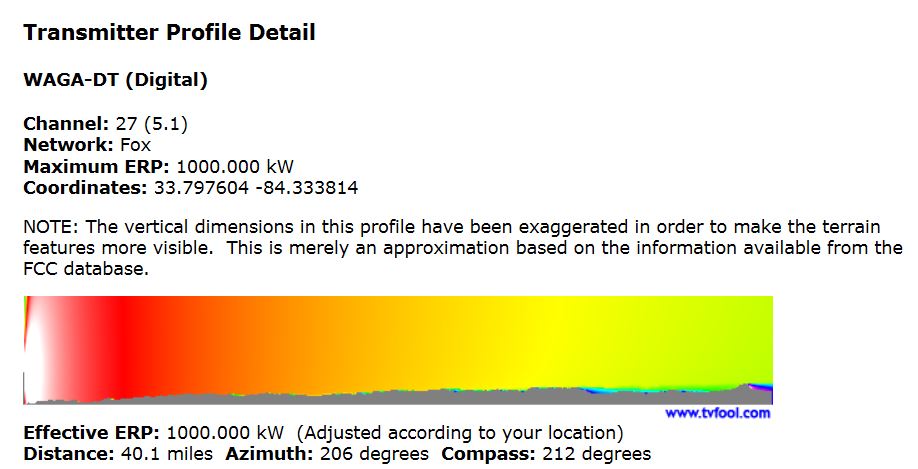

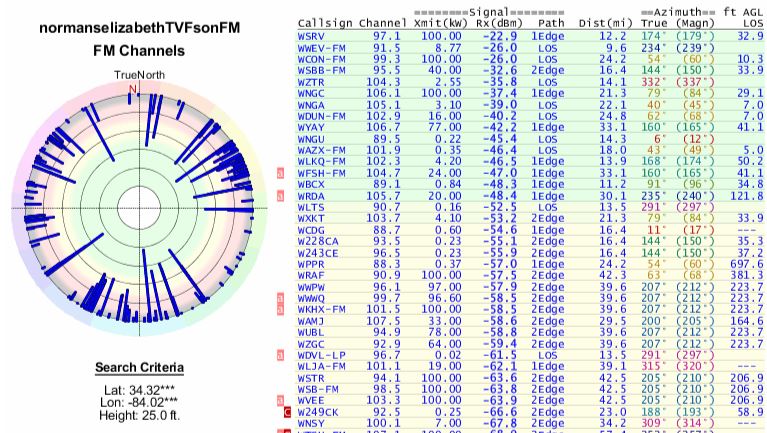

When I read your description I thought I was going to see many strong signals in the same direction. But, the report doesn't seem to match your description. I don't see transmitters 8 miles away and the location seems to be closer to Chestatee than Dawsonville.
Assuming the report is correct,
WXIA NBC, real channel 10, virtual 11.1, NM 16.3 dB, 210 degrees magnetic
WAGA Fox, real channel 27, virtual channel 5.1, NM 12.3 dB, 212 degrees magnetic
WGCL CBS, real channel 19, virtual channel 46.1, NM 14.0 dB, 212 degrees magnetic
WSB ABC on real channel 39, virtual channel 2.1, might also be possible, but it is a little weaker.
Those signals are listed as 2Edge which makes them less reliable because of terrain obstructions. I would like to give a guarantee for the young couple, but hesitate to do it because of so many unknown factors. See example in attachment 1.
