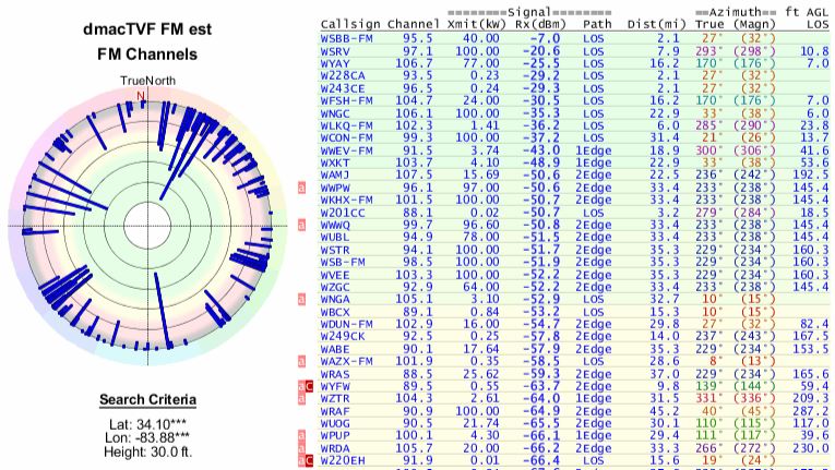

I estimated your location as west of Chateau Elan Golf Club, south of Duncan Corners, near Duncan Creek and see a lot of trees that would be in the SW signal path from Atlanta. See attachment 1.
Attachment 2 is an FM Fool report showing a strong signal that might interfere with TV reception.
