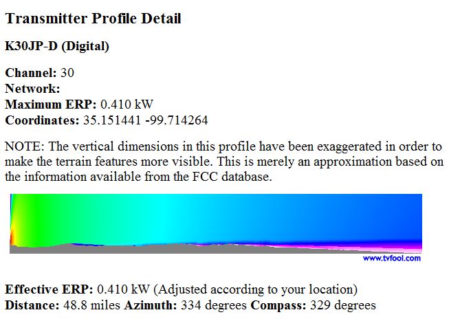

Special channel k30jp -11.1 nm dB 48.8 distance and 334 degrees. What rooftop at 27 height would work?

Old 6-May-2015, 11:15 PM   #5
Hi, Harold:
Is it good enough?
Probably not for 100% reliable reception under all conditions, but it has been done at times because the tvfool report is only a computer simulation. If you are willing to take a gamble, go for it. You can see how the signal runs out of energy by the time it reaches your location. It is in your favor that you are in the "wide open spaces."
You would need to go to 200 ft to get your K30JP NM up to -10.2:
http://www.tvfool.com/?option=com_wr...f1f051db74fc37
and up to 400 ft to get it up to +1.4 dB:
http://www.tvfool.com/?option=com_wr...f1f06b12a09a2f
A Noise Margin of zero is the weakest signal that can be received. You can add your antenna gain of about 13 dB, which brings the NM up to +1.9 dB. You can also add your preamp gain, but you must subtract its noise figure (NF), because its internal noise reduces the SNR (Signal to Noise Ratio) of the signal. This should give you enough gain to overcome the coax loss and will improve the system noise figure.
Disclaimer: I can't guarantee that this will work; you are on your own. I never want to discourage anyone from doing antenna experiments. I always learn something from my antenna experiments, especially the ones that don't work because I have to figure out why they didn't.

A 410 watt station on a 410' tower almost 50 miles away is pretty much going to be a "no-show", no matter what you put up in the air or how high you put it.

Not to mention that according to the terrain profile he's down in a hole from that tower.

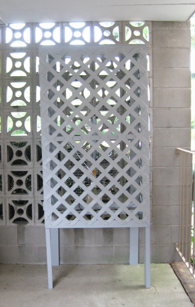

Antenna enclosure on porch for CM4221 and folded dipole for VHF-High in attachments. The signals have to travel through the openings in the decorator blocks on their way to the antenna. Not much attenuation for UHF, but a lot more for VHF. The openings act like a high-pass filter, as their size is related to wavelength.

I added this and used 5 for height. If I go higher I get higher NM. I'm also changing to a uhf antenna. I'll post results.
harold is offline   Reply With Quote
Old 27-May-2015, 11:54 PM   #18
Your new tvfool report is at a different location. Did you move, or is this one more accurate?
Why? Is that the new height of your antenna?
That is normal.
Why? Does that mean you don't need any VHF channels? What UHF antenna are you going to use?

It is more accurate and entered many different height numbers. The 5 ft gave me -8.5 nm and. 27 ft is -11. something. The only vhf channels are 12 & 7 display channels and 8, 11 real. Twelve is PBS and available on 19 k19aa less than ten miles at 353 degrees. Seven is ABC at 123 degrees. Another Abc is available 5 k42ib at 333 degrees. The uhf antenna I intend to install is the b91x.
