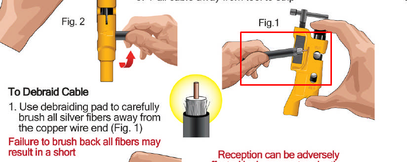

There are two ways to deal with the braid: fold it back over the outer jacket or remove it; AD says to remove it.
http://forums.solidsignal.com/docs/H...%20Coaxmax.pdf
Debraiding
Antennas Direct recommends that
especially if you are using their
connectors, the cable be fully debraided.
In other words, no little wires from the
braid should be visible. If you prefer, you
may fold the braid over the jacket (the
black plastic) smoothly and evenly.
To debraid the cable, rub it briskly against
the debraiding area several times until
all the little wires come off. At this point,
inspect the cable. All the braids should be
removed or folded over the black jacket,
and there should be no cuts in the foil.
You should not be able to see white foam
through the foil. The center conductor
should be nice and straight.

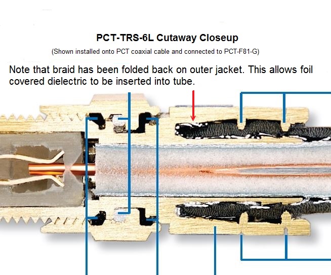

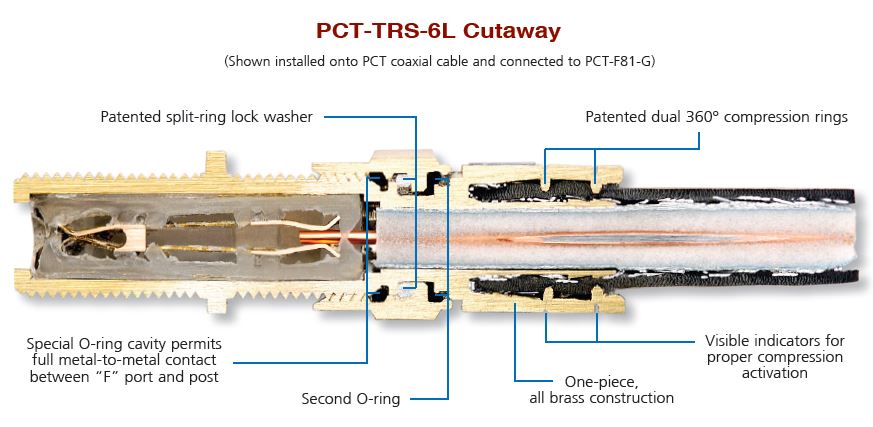

PCT claims that their PCT-TRS-6L is a universal connector for different sizes of RG6:
http://www.channelmaster.com/RG6_Com.../pct-trs6l.htm
http://www.pctstore.com/F_connectors...p/pcttrs6l.htm
video on same page
http://pctcorporate.com/images/stori...20111107c_.pdf see p2 for cutaway
Our directions for the COAXMAX say to brush the braid back. I don't know who might have told Solid Signal otherwise for their review...
Excerpt from http://www.antennasdirect.com/cmss_f...structions.pdf

I also think the shield wires should be folded back on the outside of the jacket for two reasons:
1. This makes it easier to insert the foil covered dielectric into the inner tube, and the tube under the braid.
2. The braid males better contact with the shell of the connector to conduct the current for a preamp.

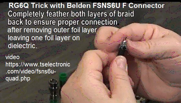

With RG6 that has more than two shield layers, like tri or quad, it is sometimes necessary to remove one or two outer layers to end up with foil and one braid layer to fold back to be able to insert the cable into the connector.
Installing Snap-N-Seal ProSNS connectors on Quad Shield Cable
There is a trick to installing Belden ProSNS FSNS6U F connectors on RG6 Quad Shield Cable!
Play video:
https://www.tselectronic.com/shop/pr...onnectors/2026
https://www.tselectronic.com/video/fsns6u-quad.php
My guess would be a Solid Signal employee who has made hundreds of custom length cables with compression connectors.
http://www.solidsignal.com/pview.asp?p=sscbls
