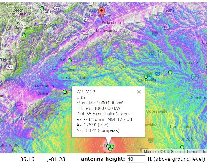

If you look at the coverage map for WBTV CBS you will see that it barely makes it up to your location:

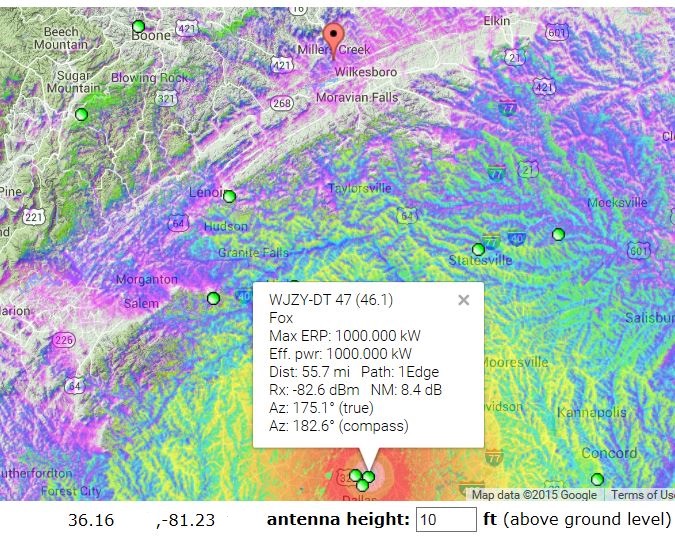

Attachment 2 shows a similar map for Fox.
Attachment 3 shows the transmitter terrain profile for Fox. You can see how the terrain interferes with the signal. You can click on any callsign in your TVFOOL report to see the terrain profile. The transmitter is at the left end, your location is at the right.
