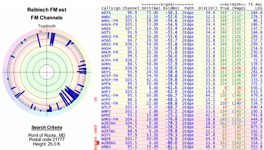

I don't see any problems with strong FM signals causing interference.
