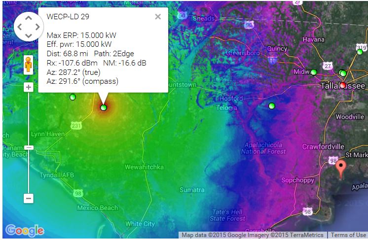

Here is a coverage map for WECP. You can see there is no signal left at your location:
The curvature of the earth is blocking the signal:

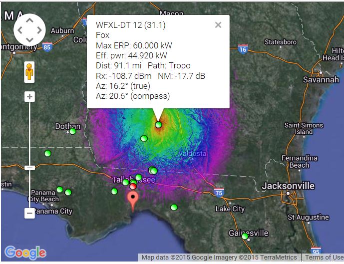

Here is the coverage map for WFXL:
and the terrain profile:
