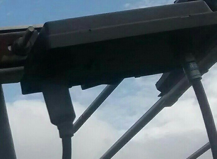

I looked on the amp for a model number and was not able to find that. All I know is the amp is an old winegard amp. My setup is using the old dish network setup on the satellite mount on the peak of my roof with the height around 20ft off the ground. I have no trees or obstruction it's wide open soy bean fields around me. I am using RG6 cable that I am screwing into the amp block on the antenna, that cable runs down the side of my house into a splitter. I then have a 25ft RG6 cable running from the other side of the splitter into the pre-amp side of my power supply for the amp inside the house. I then have a 2ft coax from my amp power supply to the back of the tv. I also have a 2ft coax that goes from the amp on antenna to the cartridge board. I have a rotor on the antenna in which I have rotated in all directions to re-scan and see if I could pick up additional channels. If you need any additional details just let me know, thanks for the help.

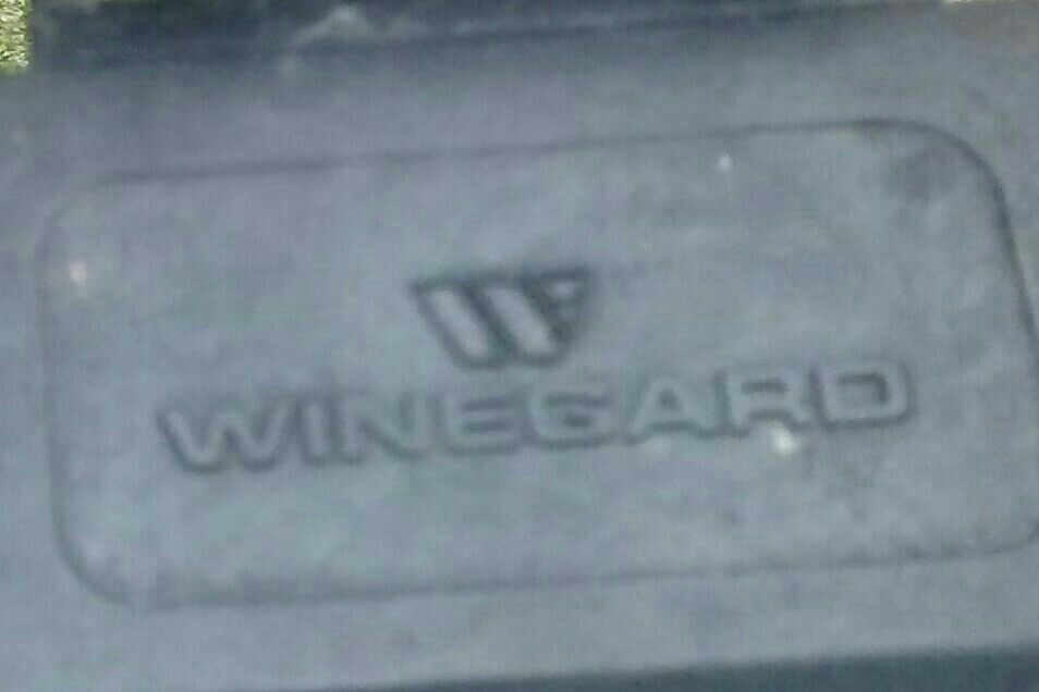

Is there any way you could get pictures of each part of your system and a diagram as to how you have everything connected. I can't quite follow your description.
Old 25-Jun-2015, 10:41 PM   #15
handaspencer
Join Date: Jun 2015
Posts: 36
If you need any additional pics let me know.
