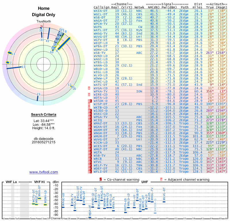

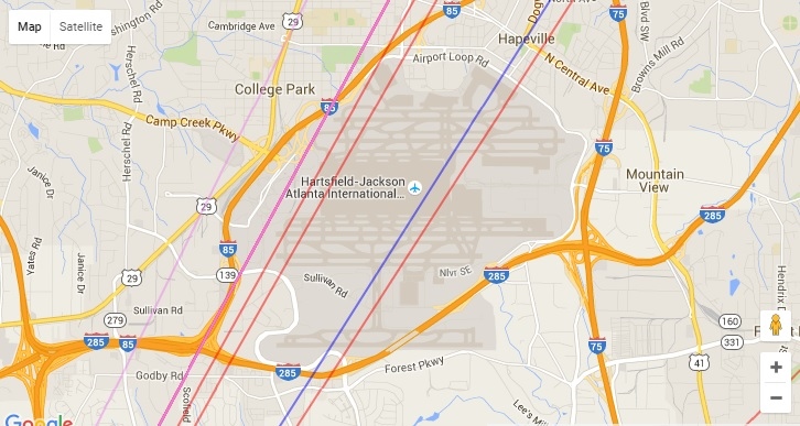

Enclosed, please find my Signal chart and a map of the ATL airport with my path's represented from Antenna.org. You can see that my paths go DIRECTLY above the airport.
I am 29 miles from the antennas and the report shows me at 2Edge but I think I am LOS. Most of the time, I have 70-90% Signal Strength, 90-99% Signal Quality and 100% Symbol Quality, 60-80%. I have a newer DB8 in the attic with less than 10 feet of cable to the receiver. No amplification is used.

Welcome, Steve:
Sorry that you are having reception problems. I agree with ADTech, it is more likely the aircraft in the signal path than RF interference. If it were electrical interference, it would have a different timing pattern, but you could check that out with a portable radio that tunes the AM broadcast band.
Thanks for the tvfool image, but a link to the actual report is more useful so that we can click on a callsign to see the terrain profile.
I don't have your exact address, so I derived an estimate of your location from your report to make an analysis. I think I'm pretty close with this report:

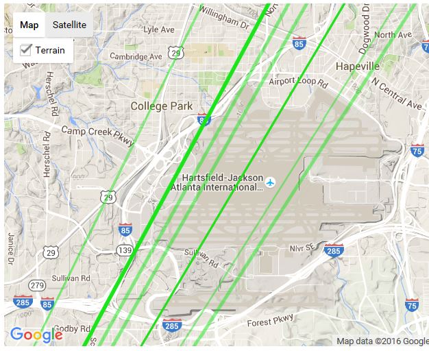

and I did a signal line map using the tvfool interactive map browser that is close to your map
your map

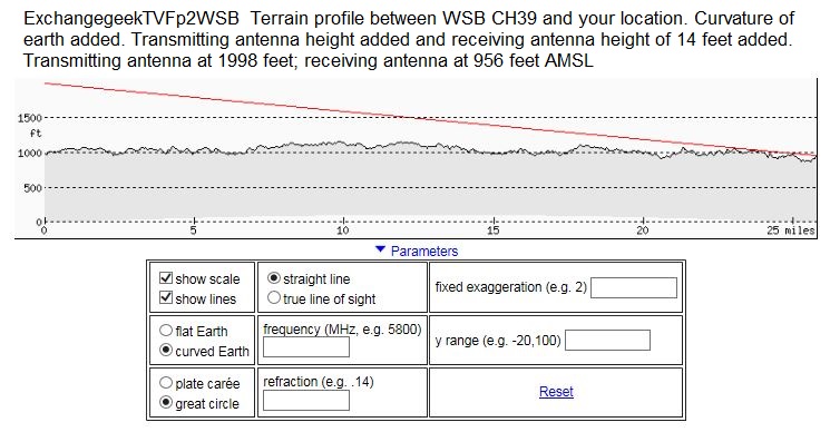

I did a terrain profile that shows the WSB signal grazing a few peaks on its way to your antenna, so I think the 2Edge designation is justified, especially since the computer simulation doesn't include ground clutter
The proof is, when I raise your antenna to 30 feet, I see LOS for some signals
http://www.tvfool.com/?option=com_wr...e2cb40e510602f

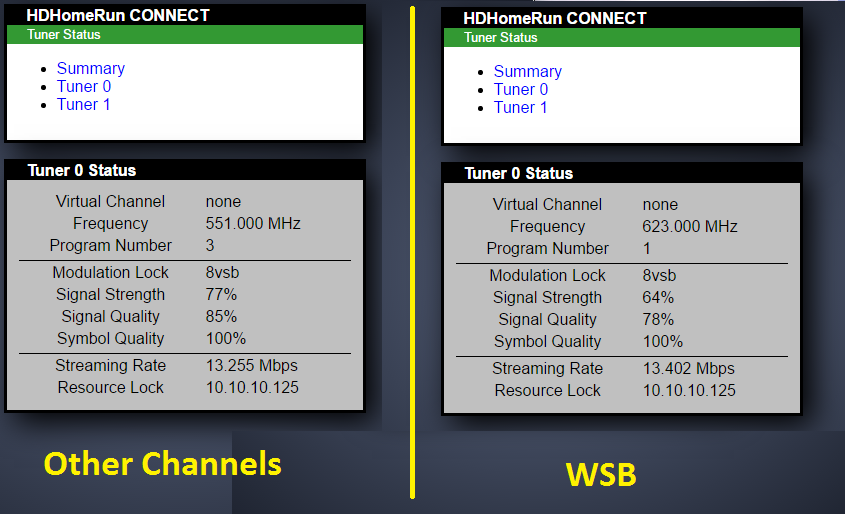

You are also spot on with the device! Instead of splitting the signal and sending it throughout to various TVs I bought an HDHomeRun device and connected it to my network. Since my house has wired ethernet, this setup works perfectly so I can watch OTA from my TVs , my computer or my Projector outside. I am impressed with this device and am watching TV on my computer as we speak. I can also monitor the signal live from the device's admin page. I don't know how long the device will last but it works incredibly well.
On a side note, I screwed up my numbers accidentally. All the numbers I posted before are correct, but I accidentally added some at the end that should not be there. 70-90% Signal Strength, 90-99% Signal Quality and 100% Symbol Quality is my typical numbers and results in a perfect picture most of the time.
Enclosed, is a snapshot of my typical signal strength. Most Channels appear as the left image but WSB as you pointed out is weaker and on the right. Right now there is zero flutter so my picture is perfect.

Thanks for the images and the correction
551 is 27
623 is 39
As a first step, try to improve your signal strength by adding a preamp close to the attic antenna; maybe an Antennas Direct Juice.
