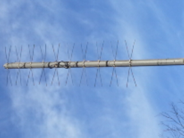

I built an antenna, 10 pairs of 7 inch whiskers with the tips about 3 inches apart. We currently receive broadcast channels (real channel) #10 (10), 27 (28), 33 (19) and occasionally channel 51 (50).

Soooo, maybe I can get it right on the third attempt. I got busy today and forgot about taking a picture of my antenna before the sun went down. I used some measurements I found on the interwebs to build from. That was before doing reading on this site.
I started with 20 pieces of 6ga copper, 18 inches long. I bent them in half with the tips at 3 inches apart. The mast was 2 inch pvc elec. conduit. I put a pair of holes 3/4 inches apart down 1 side spaced vertically at 7 inches.
I used 14ga copper to solder both parts of each whisker 7 inches from the ends. The top two pairs are connected straight down to the second pair, then cross over. Each two pair follows that pattern.
That is a horrible discription, but the best I can give right now. I just got off work and took some cold pills. It makes it hard to focus, like I got cotton in my head. I'll get a picture in the morning.
Thank you for your patience with me.

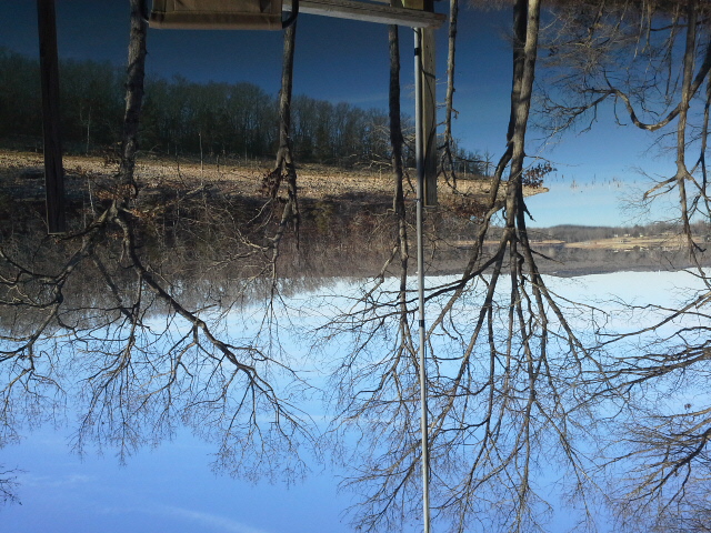

Here is a picture of the antenna and one facing North as well. I hope they answer sone questions. The exact location is 36.58326 by -93.56376.

With the antenna I made, I didn't put a reflector on it so I had a better chance of pulling in 51. In my future I will be putting a tripod mount on the roof. That will gain 10 or more feet to my setup. We just moved a modular building on site and are converting into a house. Right now the antenna is on a 20 ft. pipe clamped to a 4x4 deck post.
It's interesting, but I am very rural and have a great view. My wife would like to get the pbs channel 21 back so I think I'll need to add a second vhf (?) antenna to get it back. For now as long as CBS on channel 10 stays strong I'm happy.
I'm just not sure why that little Lava antenna my neighbor uses does so good.

I've looked all over the internet for the type of antenna you built and can't find anything on it.
If you want to make your own I can recommend Mclapps DB4 or DB8. I have made several of the 10 x 9.5 DB4's and can say they just work great for me.

I spent some time and was able to locate the above sea level elevation for channel 10, KOLR in Springfield. The hole we are in is approx. 50 feet in elevation lower than the transmitting antenna.
This makes sense to me since I get a decent signal with a very poorly designed homemade antenna as does my neighbor with his Lava antenna. Springfield is in a relatively level area so without spending my data package to look at each transmitter, I would guess roughly similar elevations for the other stations.
I want to thank you for your reply. I don't thing the heroic measures will be in my immediate future., however using the two antennas mentioned seems a good place to start along with raising my antennas to the roof with a five foot tripod and ten foot of mast and some careful aiming. That increases my antenns height about twenty feet above where my antenna is now.
