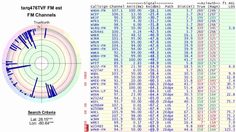

You have some strong FM signals that might interfere with TV reception. If so, insert an FM filter between the antenna and the tuner. See attachment.
